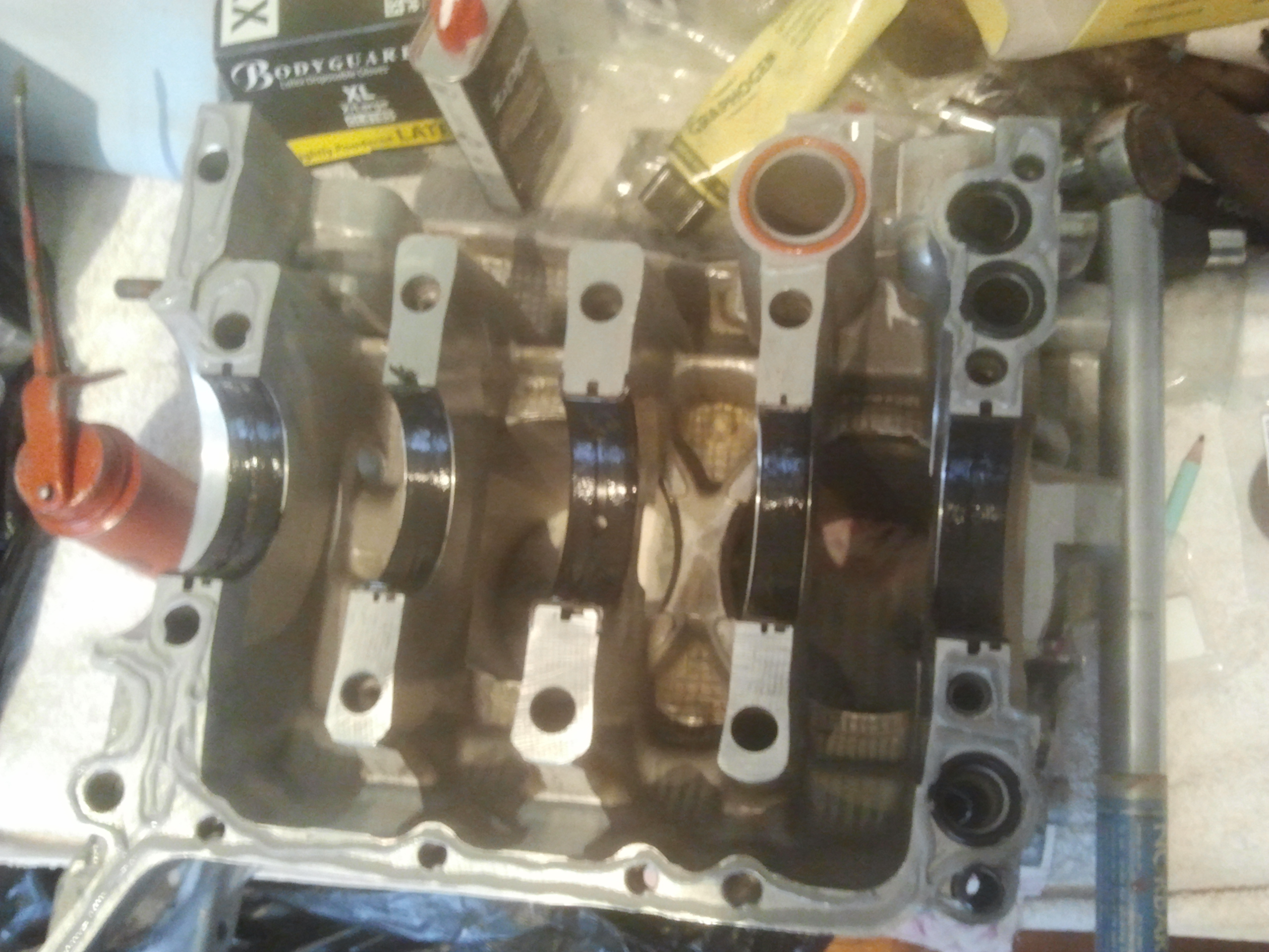

my wrx bottom end shells gone
does any 1 know if there is a way round taking the full engine out to replace the shells on my 2002 impreza??
your answers will be appreciated
post-3542-0-55319300-1418600337_thumb.jp
cheers (savage bulldog) so once the engine is out can the heads stay on or do they need to be removed before splitting the engine?
Heads have to come off to get to the block bolts to split it and the pistons have to be removed before the block can be split .

Bottom end rebuild is a major job. Takes the best part of a day just to get the engine out!
