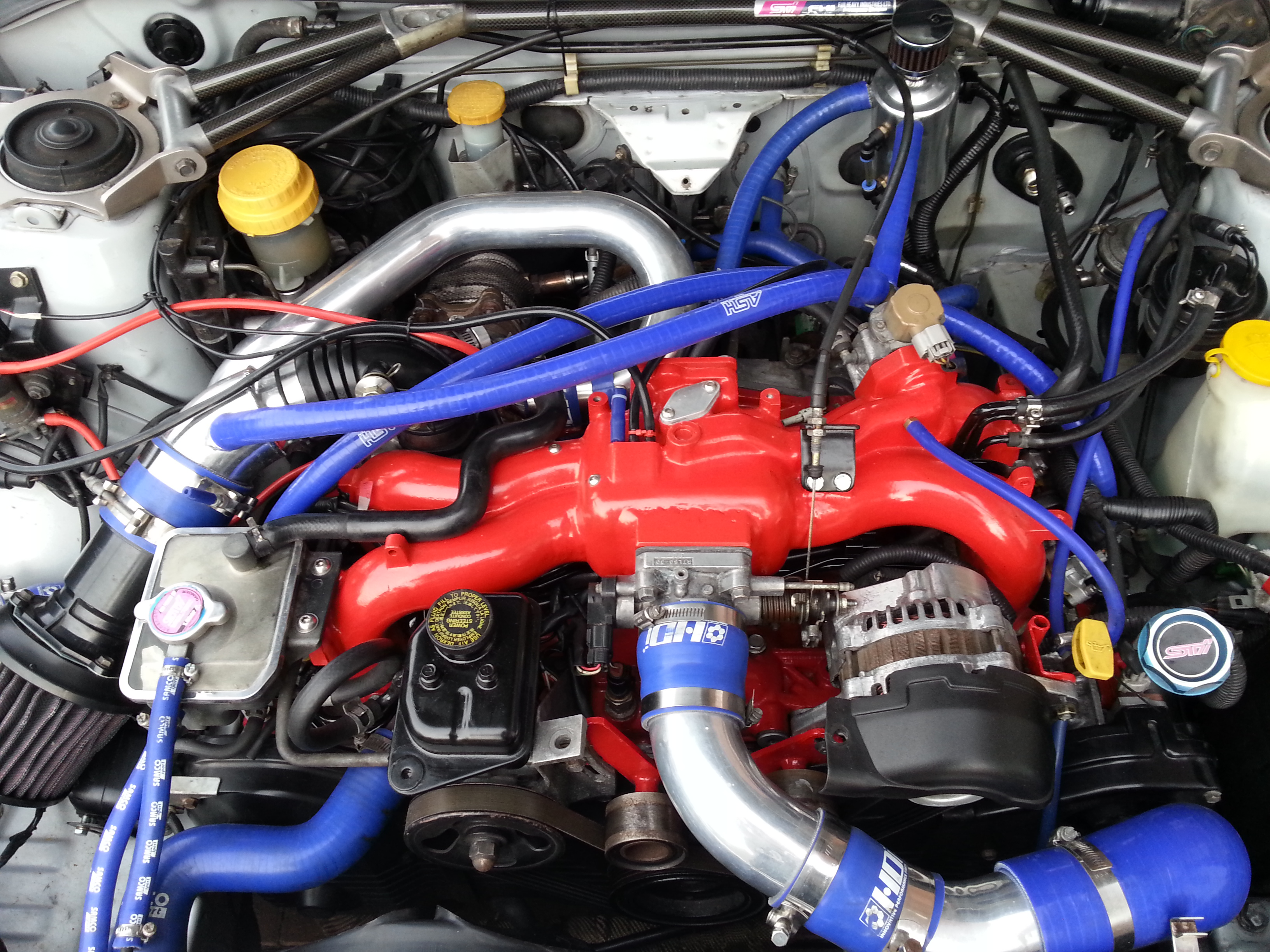

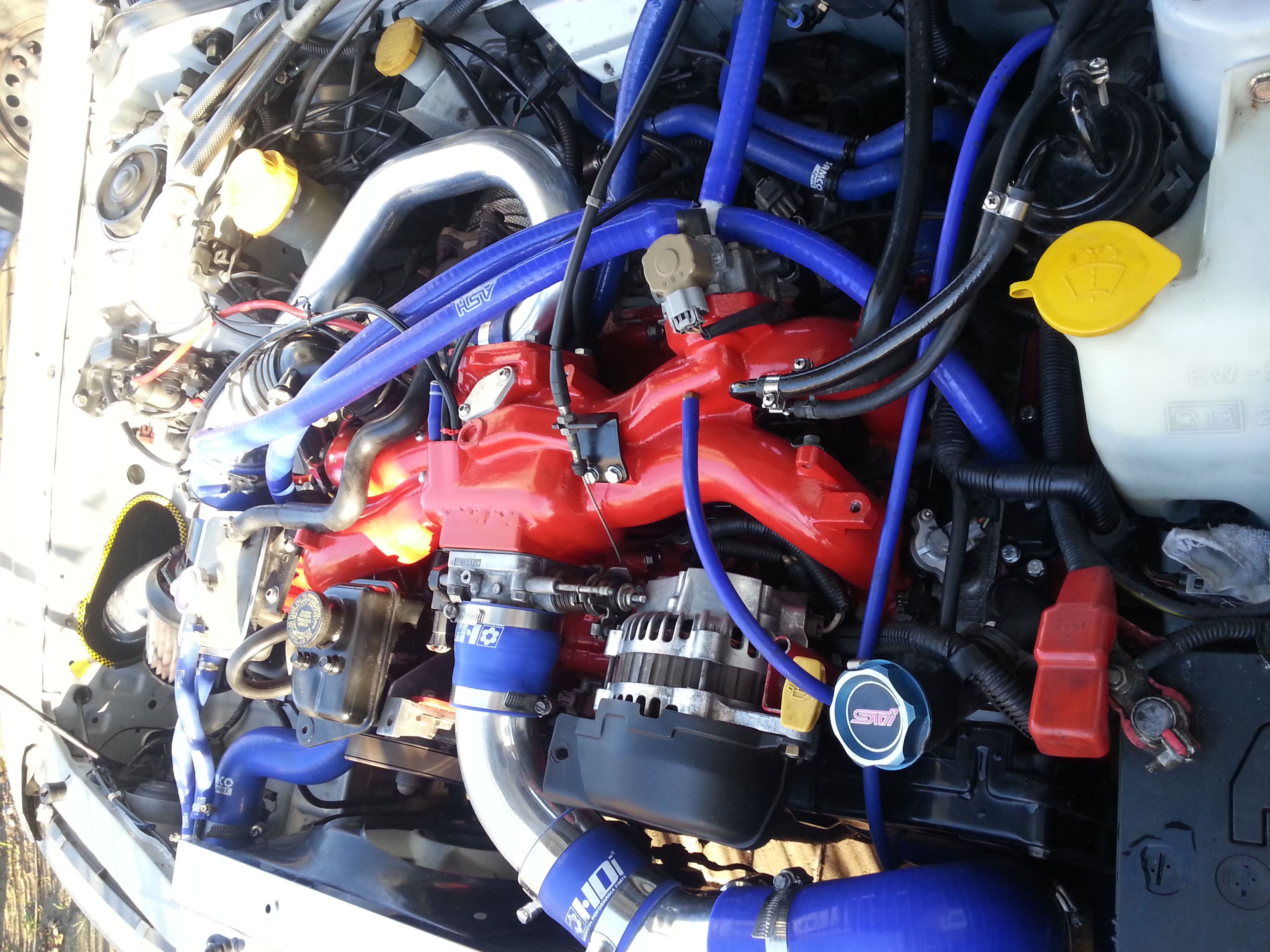

Here's a pic of mine to show the breather location and the stiff blue ash hoses
Cheers nevell
Mine vents to atmosphere via a filter on top as I couldn't be arsed to plumb in a return to sump plus baffled cans that return to sump set ups are expensive (think my eBay can was £30 ish) so I just keep a eye on both the can and my engine oil levels .
Only issue I've had with the position of my can is I sometimes get a slight wiff of oil as its close to the air intake for the heater/blower .
I might run the vent line down the gearbox tunnel at a later date
