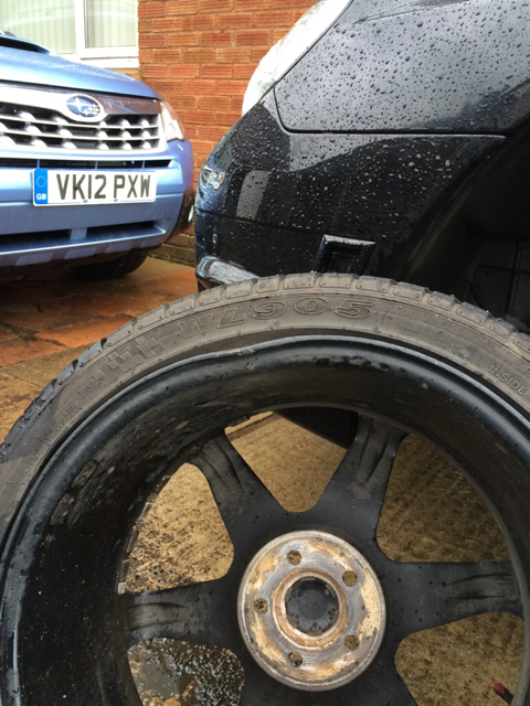

My passenger front wheel looks like this: post-3486-142462432891_thumb.jpg
It holds air perfectly fine, and before I noticed it, would be fine at high speed too! Is this likely to get through an MOT, or am I best getting it repaired ASAP?

I doubt the wheel will pass as it's knackered lol.

Verdict on the wheel then- get it sorted before MOT? :/

Yeah mate I'd get the wheel sorted ASAP could be stressing it in places that could cause a premature fail

As for the wheel, looks like i'm gonna have to look into getting it repaired then!

depends how lucky you get with the MOT but I think they will fail that if the see it :(
My MOT blokes great but I think he would fail that for me :(
No it's unsafe so major fail ! My mate is pretty forgiving but won't let me get that thro
Hi guys! Just a bit of an update: Got the wheel fixed as advised and car flew through the MOT on Tuesday...
Bar an advisory 'slight play in NSF wheel bearing'- I have no doubt that this was caused by the unbalancing of the buckled wheel, so i've learned my lesson: wheel damage can cost more than the repair of the wheel if not dealt with swiftly!
