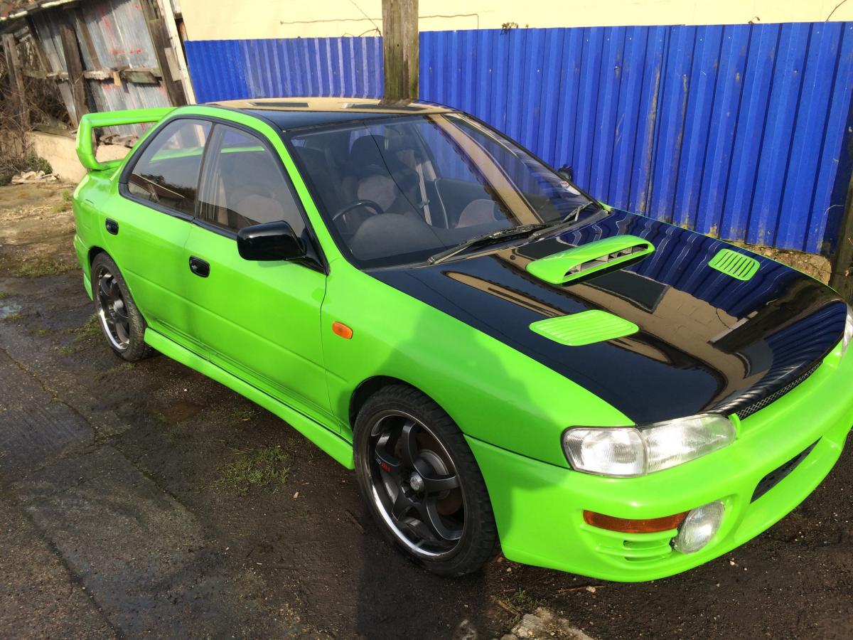

Sxvmark
Wotcha and welcome - loving the colour scheme - clearly you are a bit of a shrinking wallflower :D
Lol cheers Jay needs a bit of engine work bottom end but the rest of the cars quite good
Hi n welcome to soc you certainly won't have any trouble finding that in a car park , both of my classics are common silver .
