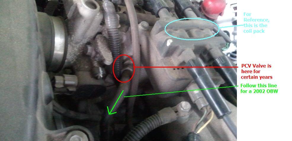

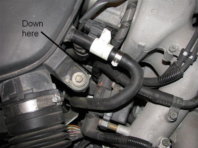

The pcv valve is in different locations depending on model/year. When you access/remove it (the black tubing needs to come off, then unscrew the valve from the manifold) the valve should rattle when shaken. Clean if necessary using a squirt of WD40 or suitable degreaser and reinsert; or replace.
I'll try and attach a couple of photos, need to check if either resembles your motor.

Cheers the second photo looks like mine.
I'll pull the PCV valve out and give it a clean.
Never even knew they could get blocked or should be checked regularly.
