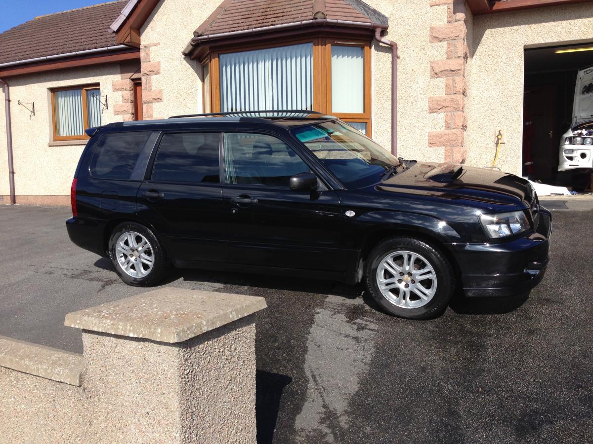

The Ride height doesnt look too bad (pic below), the current owner says that the owner before him put them on and he's readjusted them for more height so hopefully it wont be too bad, he's still got the original suspension so i could always swap it back.
Its is indeed a 2.5l and its in Scotland, a mission and a half away from me in Birmingham but im working a few hours away their next month so its not as bad.

The suspension has probably been changed due to the sls units dying, so the original suspension is probably useless, however if you don't like the coil overs they are the same for the impreza so you could sell on for around 400 depending on which bc's they are, and get after market regular ones for cheaper than 1 sls unit from subaru ! you can tell by looking at other cars that have sls fitted they look like a dog scraping it's bum along the floor when they have gone.
Heads are dependant on how the cars been looked after, driving on boost when the cars cold will kill them pretty soon, however the pic you posted the chap has a classic in the background so I reckon he knows what he's doing with them.
