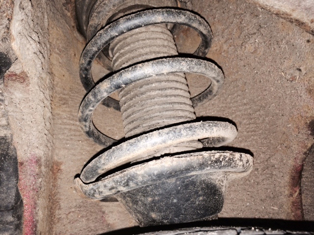

I've had a good look underneath and its currently fitted with KYB excel G on the back, cant see a part number.
does the SLS just look like a normal shock and spring? as these do

SLS is made buy tokico & looks much the same, some had external oil canister & some didn't.
If looks saggy or you carry load/towing you could try new springs & perhaps get a pair from springcoil & spec them sliightly stiffer rate & 15-20mm over standard ride height.

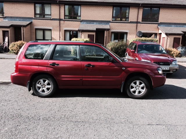

Yeh that deffo sagging on the rear .
should have stamped number on the kyb struts.
Springs more tricky on knowing what they fitted but I know if you fit the sls springs (kyb do sls spec springs as well) you get sag as they not same height or spring rate as the non sls so possible parts man ran it through computer and supplied original sls spec when should of been non sls.
Have good look at struts for numbers, if they right I would advise getting a set of springs from  springcoil.co.uk & specify 15-20mm extra ride height over their standard as then allows for some loading. If heavy towing get higher spring rates. Set of springs from them is about £130 but quality very good & they good on phone as done a few now for the forester non sls conversions.
other than the sticker on one side i can see no markings on them and just to add to it all , theres no locking nut socket !!

Yeh sounds like a plan, have good hunt round the cars holding pockets etc as may find the wheel socket, if notyou can normally bash a socket on to get them off. My guess is someone done the rear suspension & used new kyb springs but sls ones rather than non sls (seen it done more than once :-S )
Is also possible struts wrong ones but that more unlikely as kyb list them only (even for sls model) when parts put in info on the database, with springs if they see it sls model they tend supply same sls kyb spec springs unless clued up on the conversion ...

Well it is indeed possible as I seen it done & had correct it myself, both springs for the sls & non sls are virtually same besides length little different & Kg spring rates not same.
Many people tried replacing the sls with kyb strut & reuse old spring & that how found spring specs different between the 2 & need the matching non sls spring to match the non sls strut.
