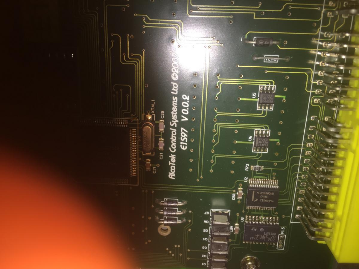

the ecu is still the mapped one.. I've looked at it but haven't opened it up. I'm not gd with electrics so don't want to touch the inside.the actuator isn't adjustable.i can move the arm by hand fairly easy but there is pressure there. Should I be able to move it by hand ?
Does it look like a standard subaru one ? There should be a number &letter on a coloured sticker. Obviously won't tell you if it's been els'd but there may be a mapper sticker on the cover

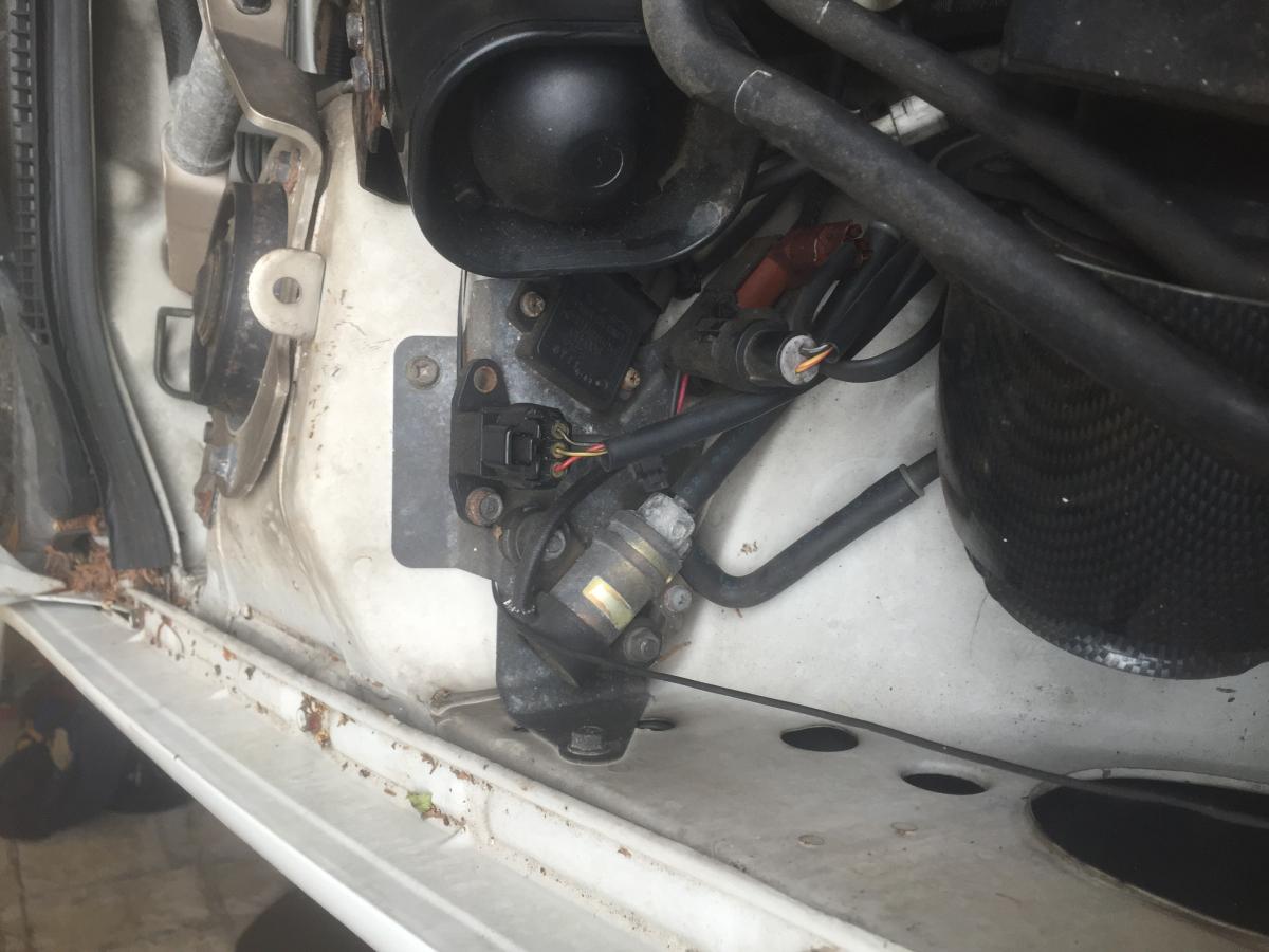

And by what I have just read that map can also delete maf sensor..as savage bulldog said. So it wouldn't be that causing bad idle if it has been deleted.
Deleting the maf can be done with that ecu but you can't be 100% sure without having a mapper check the map parameters ,especially at the moment with it not running right in the first place

Well I've managed to source a perfect working order maf the same which I'm going to try Wednesday.. See if it makes any difference. The solenoid literally clicks once when first turning ignition on.. That's it.its not a loud click I just put my fingers on it and felt it click. Almost like a relay clicking. I can move the actuator the full way till it's not supposed to go any further. And I can move it fairly easy. There is pressure there but it does move easy. Without force.
