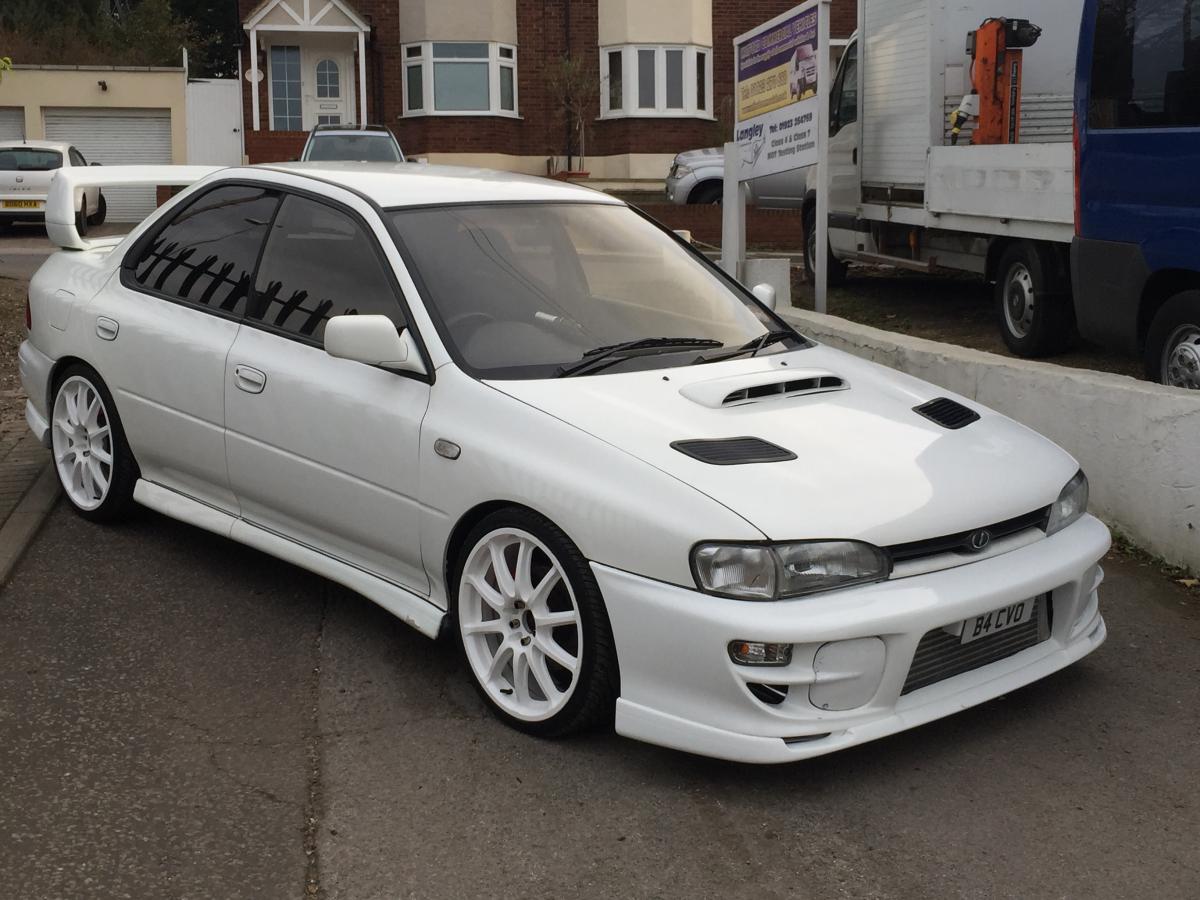

1995 jdm wrx saloon with standard internals fmic and td05
im experiencing fuel cut and boost issues -  turbo spools up kicks then boost goes crazy sometimes up to 1.8bar!! then fuel cut

post-5518-0-69165400-1450623128_thumb.jp
