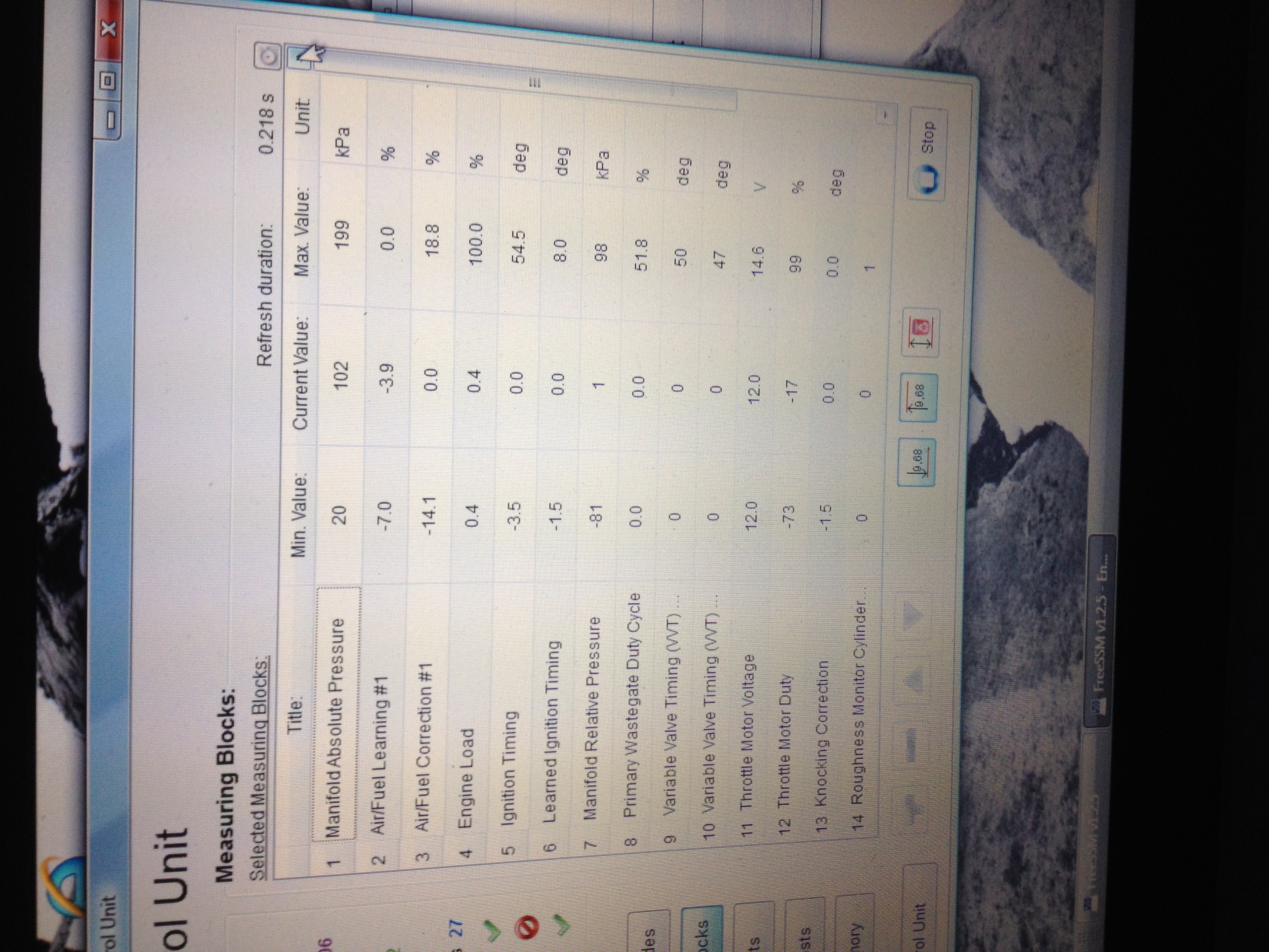

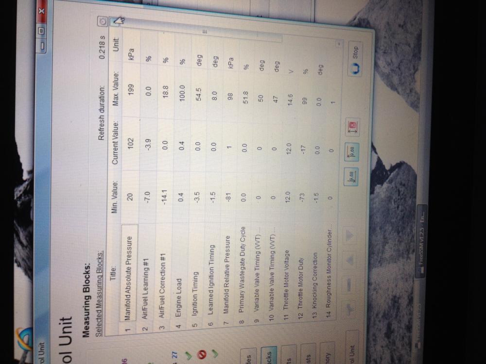

Ok, I got
air fuel correction
min -14-7%
max 18.8%
thats after a 14 mile drive

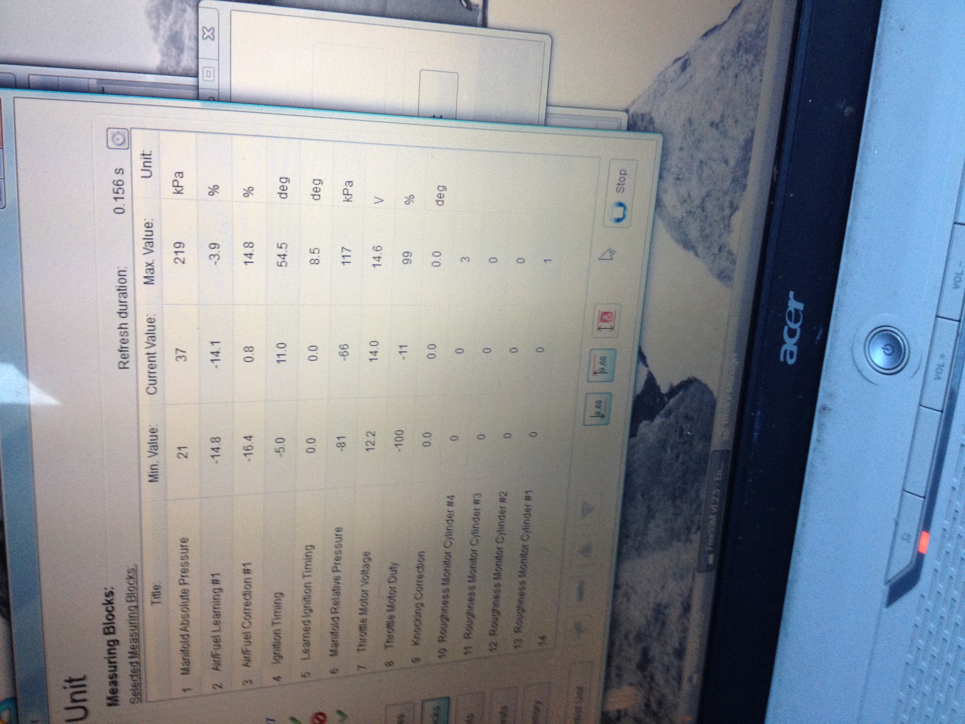

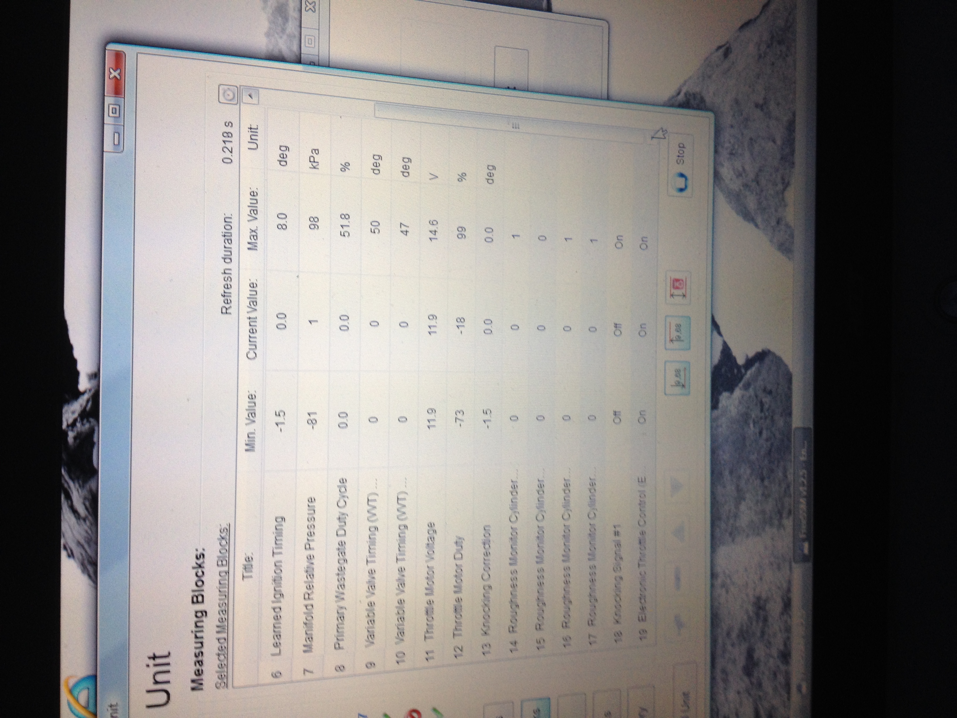

Fitted it this afternoon, took it for a run, immediately better, little more roughness on #4 but no knock correction, boost is up a few psi and so is power and driveability, afr learning and correction have changed, still got to work out what's good or bad, and it's probably best to reset the ecu as its learned some orrible stuff, but also maybe not reset it and see what it learns ? Hmmm, anyway upshot is its running massively better already, without a reset or any learning, and my start of boost stumble and any other hesitation also seems to have gone so as long as it carries on this way looks like the throttle body or the electrics on it were on the way out, see what tomorrow brings with a longer drive......
bottom pic is latest
Glad to hear it's running better not familiar with the software I know what it is but never used it unfortunately :) I'd be tempted to reset and see if anything comes back though.
Have taken that advice mate, just popped the battery off for the night, given the brake pedal a few stomps, will do the uncle scotty (I think that's what he's called) reset in the morn when it's cold and see if it all stays Rosie
