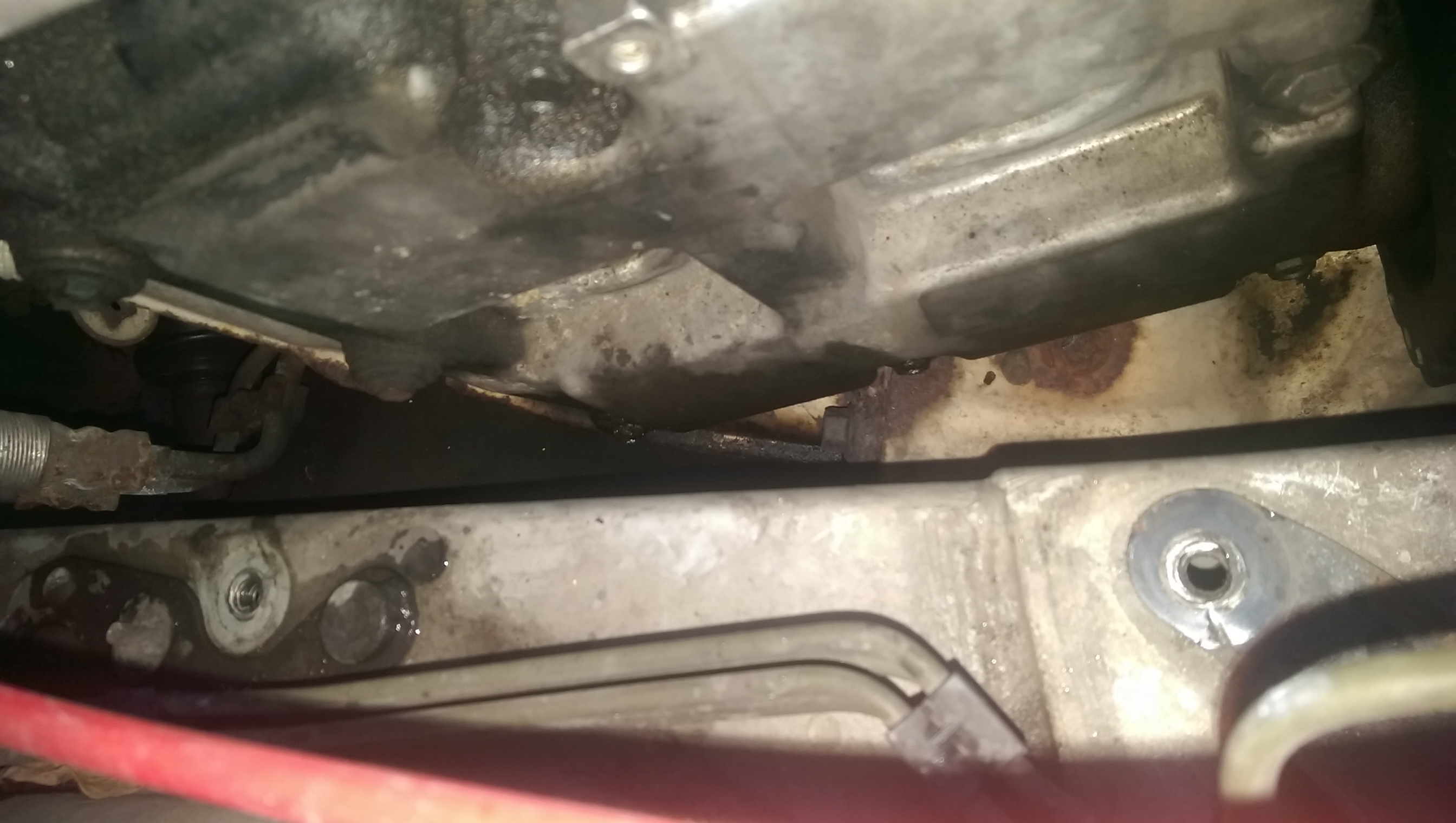

Regard to your oil leak, is it mainly the drivers side? Likely going to be a rocker cover. Recently done mine and it was a fairly easy drive-way job. Be careful with eBay as you may well have a version 6 which in Subaru's wisdom uses a v5 passenger side rocker gasket but v6 drivers side. I couldn't find a full kit on eBay but importcarparts.Co.UK stock all genuine Subaru parts.

The main reason I suggest it's drivers side rocker is that's the most common place to start leaking oil. It's caused by the exhaust being so close to the bottom of #3 area. Makes the gasket hot and becomes brittle over time.
I've added a picture of mine and you may be able to see where the oil is seeping. Have a look down there. If it gets worse or bad enough you'll get the burning oil smell as it drips on the exhaust manifold.
Thanks for that I have noticed very faint smell before now you mention it.  Will definitely check that area first.. Probably still on original gasket.. I'll get some pics tomorrow when I leave work hopefully will help diagnose..
