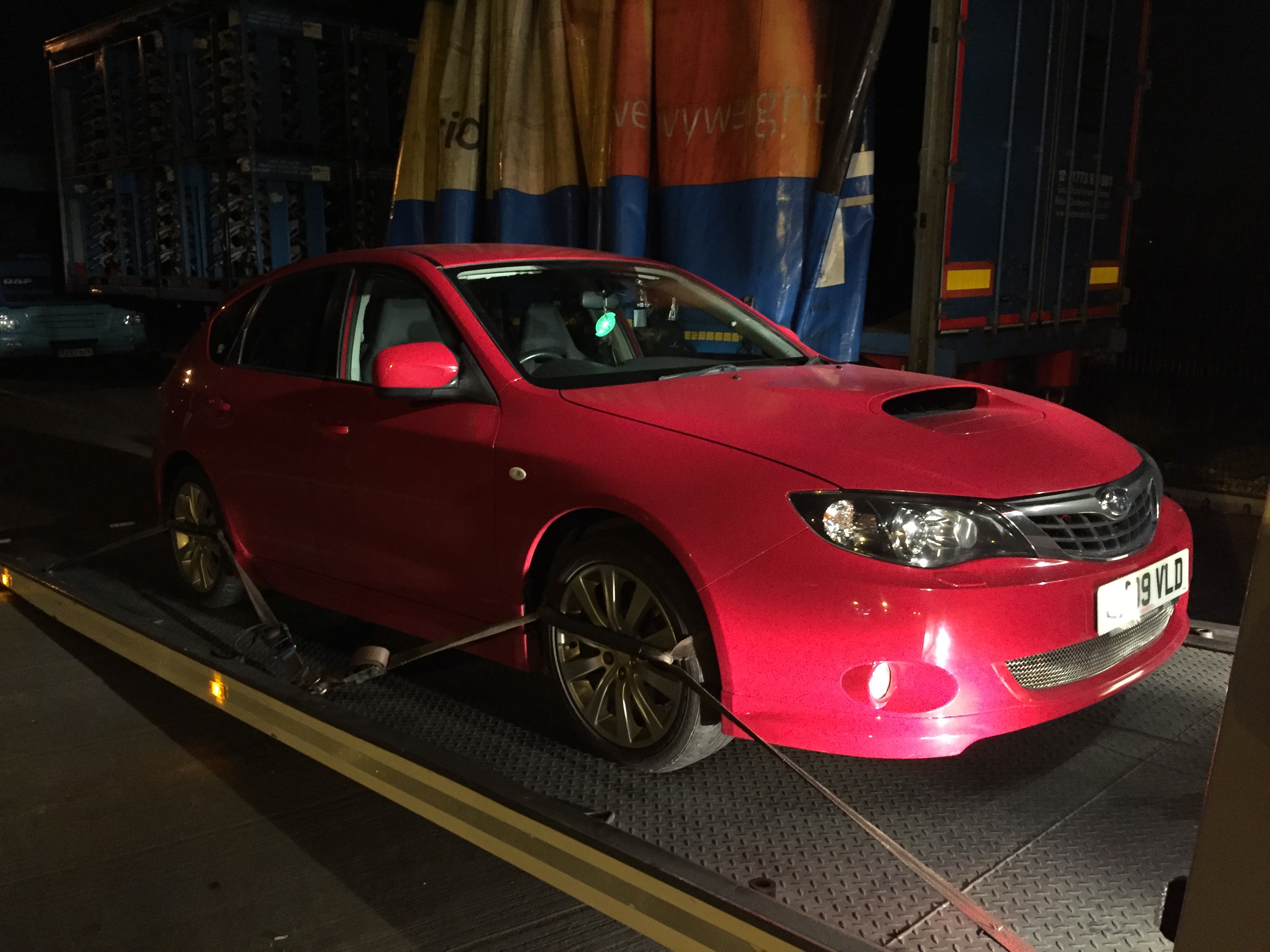

So tonight after a short jaunt down the motorway the coolant dissapeared so car has gon for further inspection but its highly likely t be head gasket

Yes piggy after jason spent the afternoon working on the car he has confirmed its HG and is now on with fixing it,he said it most likly went when the pipe split ,unless you turn it off straight away which unless ur sat under the hood watching it would be impossible to know  so hes on with stripping it now,im gutted.
