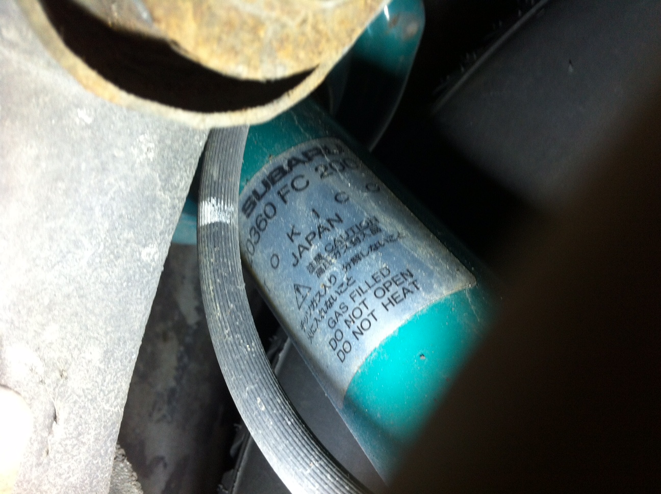

Hi, i will have to change the rear left stock absorber on a forester from 1997 90 kw the basic one.
sorry posted this topic on the general forum also but maybe the Forester pros are more convinient
my problem is: on the stock absorber is a number that does not mach with any subaru numbers (20360FC200). i called subaru and acording to the chassis N° it should be 20360FC210…but even this i can not find. My question as i DO NOT want to buy the part at Subaru’s far to expensive does anyone know what this part is and how it looks and if i cant find the pice can i mount other absorbera instead?
i post an atachment of the one that is on now
thank you verry much for some help
Christian
That self levelling strut (sls) so you will need change both sides & the springs also to non sls type.
They cheap,
See link below for more info .

Besides Optimal brand you can also get SF forester non SLS shocks from KYB & Sachs, KYB also do springs.
Just remember you MUST do both left & right when changing from SLS to non SLS and also fit non sls springs as they different spring rating.
the Tokico SLS is only available from subaru & crazy money
The aftermarket shocks & springs (both sides) will cost less than £200 in parts if shop around ...
^ yes it would, no idea on quality of parts they supplying & price not that cheap once add shipping
I would of thought you could get Optimal or KYB easily in switzerland or something shipped from Germany but whatever works out simple & best availability for you I suppose ...

Thank you i agree... quality ???
I will take KYB
