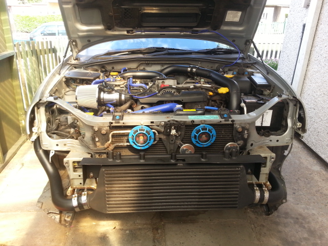

Having searched this topic I believe it's the PS pipe and others have either redirected (not sure how) or bent the bracket to tuck behind the Perrin one. I'm not sure if that is a good idea or not because of the rad but just an idea
Or to avoid the issue I found a thread where someone located both to the other side of the pipework. Not my picture attached this was from the thread
Doesnt look quite as nice though!

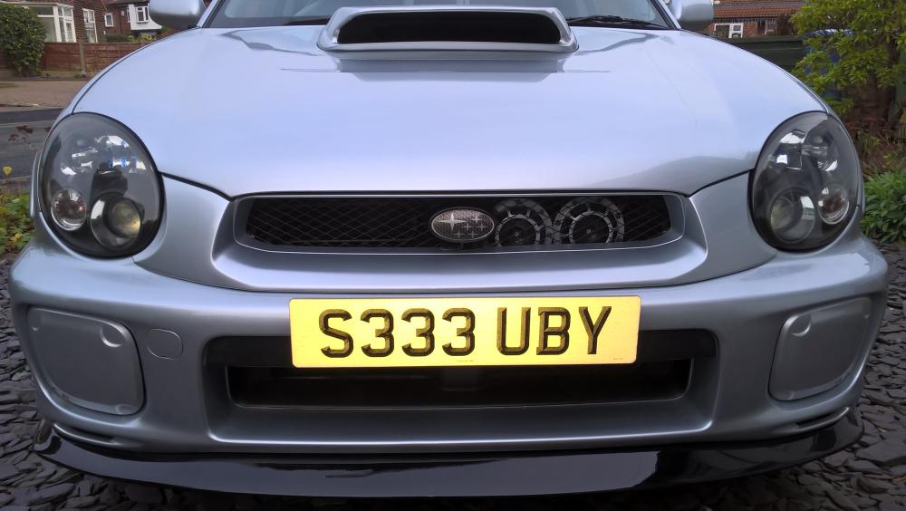

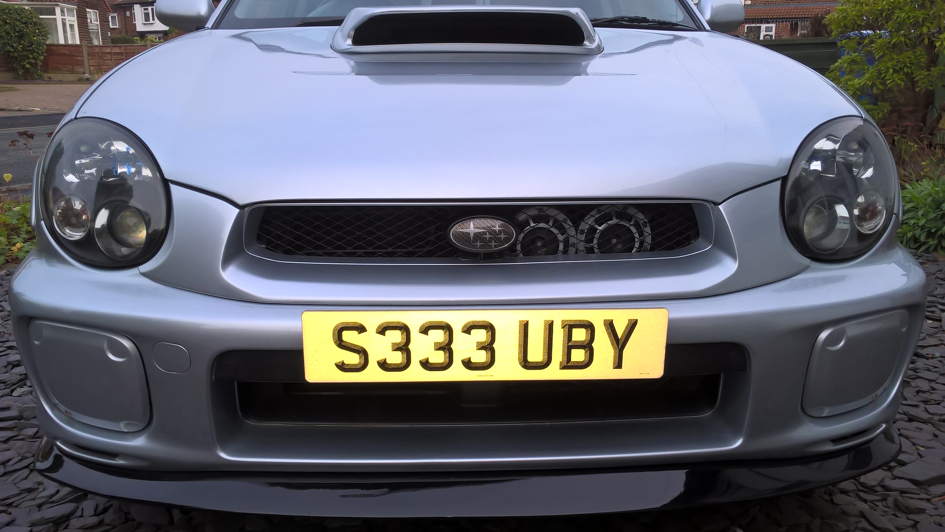

dont waste your money on the perrin bracket,just use the 2 holes on the slam panel and brackets that come with the hella horns,thats what most use to fit the horns,hang them straight down job done,its like subaru put the holes their for this very mod :biggrin: this is my old blob using the brackets and holes,for the ac pipe you can bracket to fit round it .just found my piture with bumper off on my bug i had them on as well,sould help you.2.lights.jpg

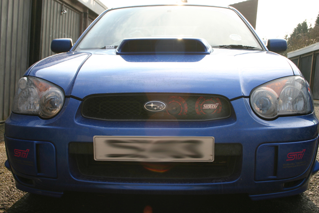

I fitted mine as jamina said 2 on one side problem was the power steering  pipe then if i avoided that i couldnt get the grill on..WP_20151228_14_55_08_Pro.jpg
