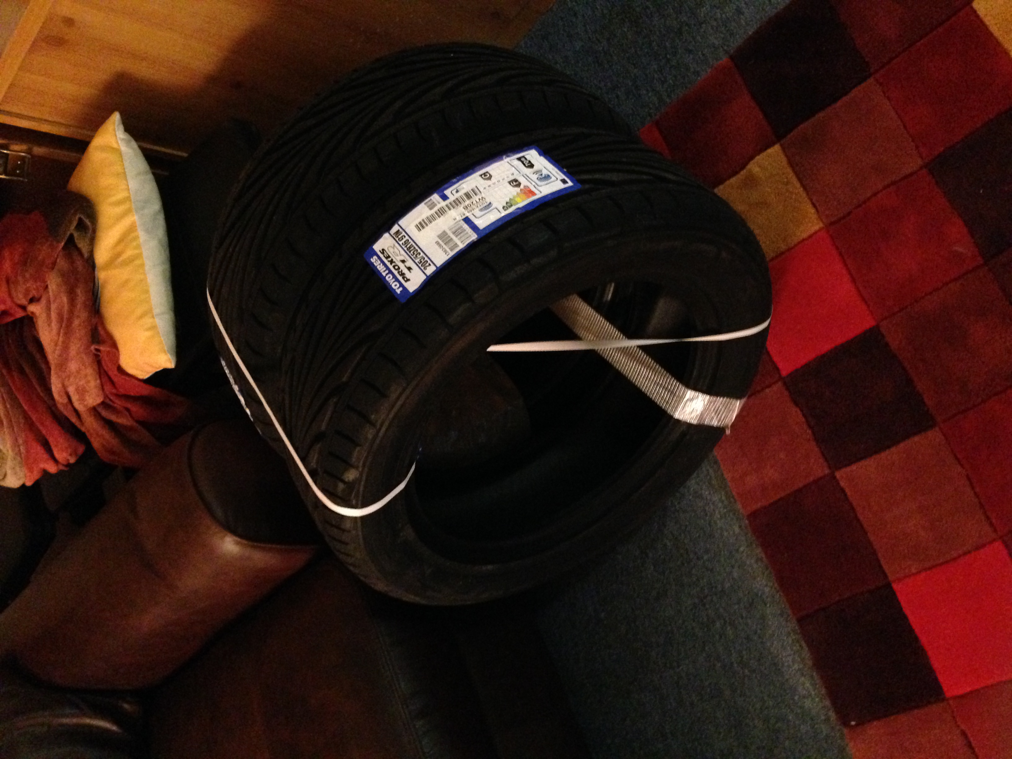

savage bulldogs Posted November 30, 2016 Report Share Posted November 30, 2016 Yeah I've got "yin Singh ditchfinders " on the back too . if I buy Uber soft tyres I tend to scrub the outsides out after about 10k . The firestones I put on the front seem to be a good all rounder for £70 a corner . So I'll probably chuck some on the rears next year . Quote Link to comment Share on other sites More sharing options...
JamesJDMwagon Posted November 30, 2016 Author Report Share Posted November 30, 2016 Yeah it's a grippy car thing I guess we just corner too fast my last set of fronts lasted six mouths completely destroyed the shoulders. I've just bought a full set of toyo t1r's for £41 a corner I do love the tyres if a little soft. Which firestones are they? Grippy? Quote Link to comment Share on other sites More sharing options...
savage bulldogs Posted November 30, 2016 Report Share Posted November 30, 2016 Firestone firehawks (I think) they seem to be rated ok and have got a "bike like" look about the tread which seems to work well . It's difficult to say if they're grippy tyres as I'm running quite a few suspension mods and its not got abs either . I wouldn't just buy the firestones on my say so anyways as I've only ever bought those and a set of sticky kumhos that we're good but didn't last . 1 Quote Link to comment Share on other sites More sharing options...
JamesJDMwagon Posted November 30, 2016 Author Report Share Posted November 30, 2016 Oh they look sexy! 😍 I've got tyres for now and hopefully longer then six months 😂.Did you delete your abs? If so why? Quote Link to comment Share on other sites More sharing options...
