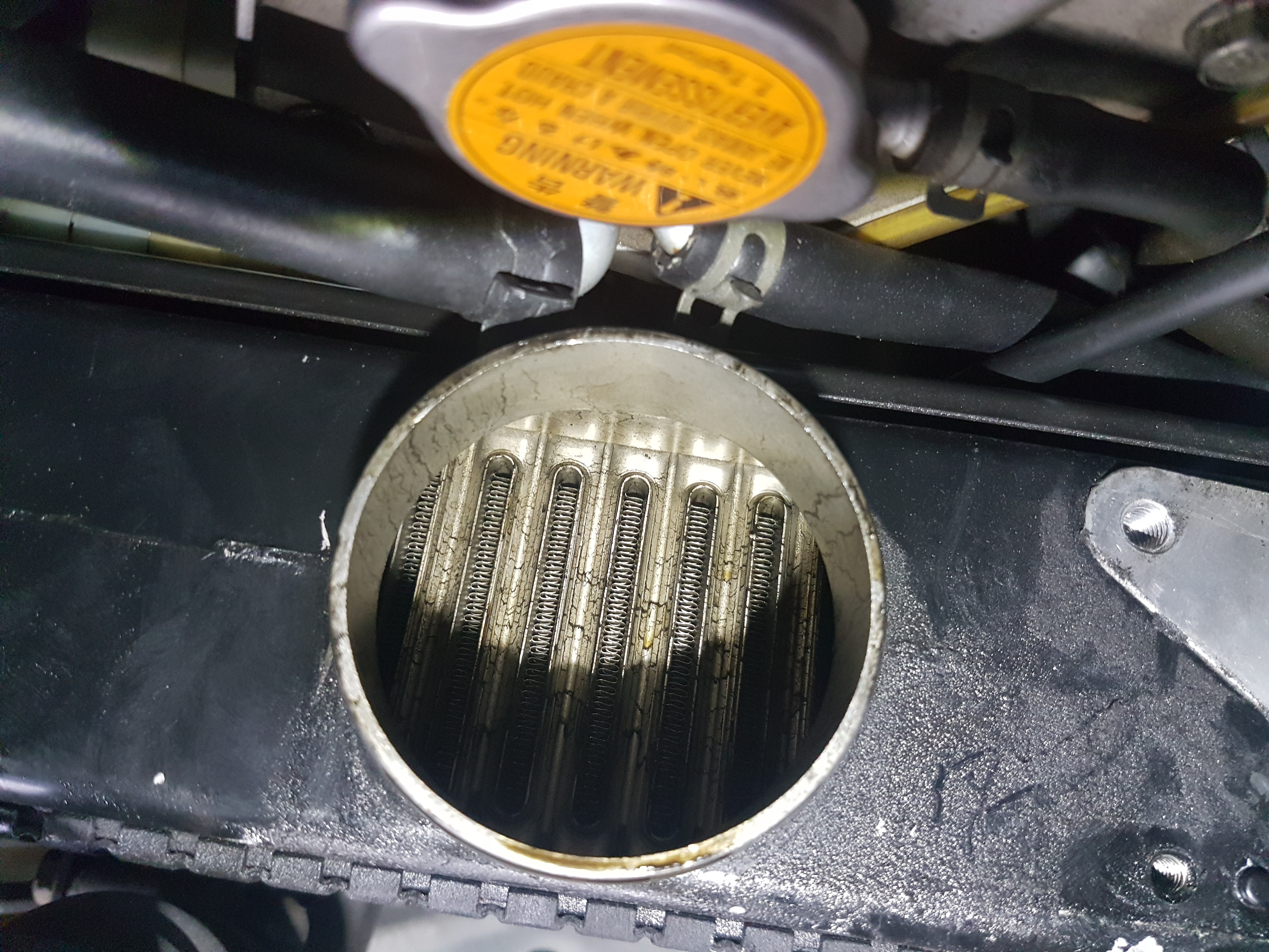

Basicly weaps past the seals, so need to pool over time to be visible. not enough to be visible under normal running, but given time to pool you'll see a puff of smoke, my old turbo did exactly that.

OK, it does sound like some oil "leakage" - "leakage used loosely in terms of what some of the others have posted.
