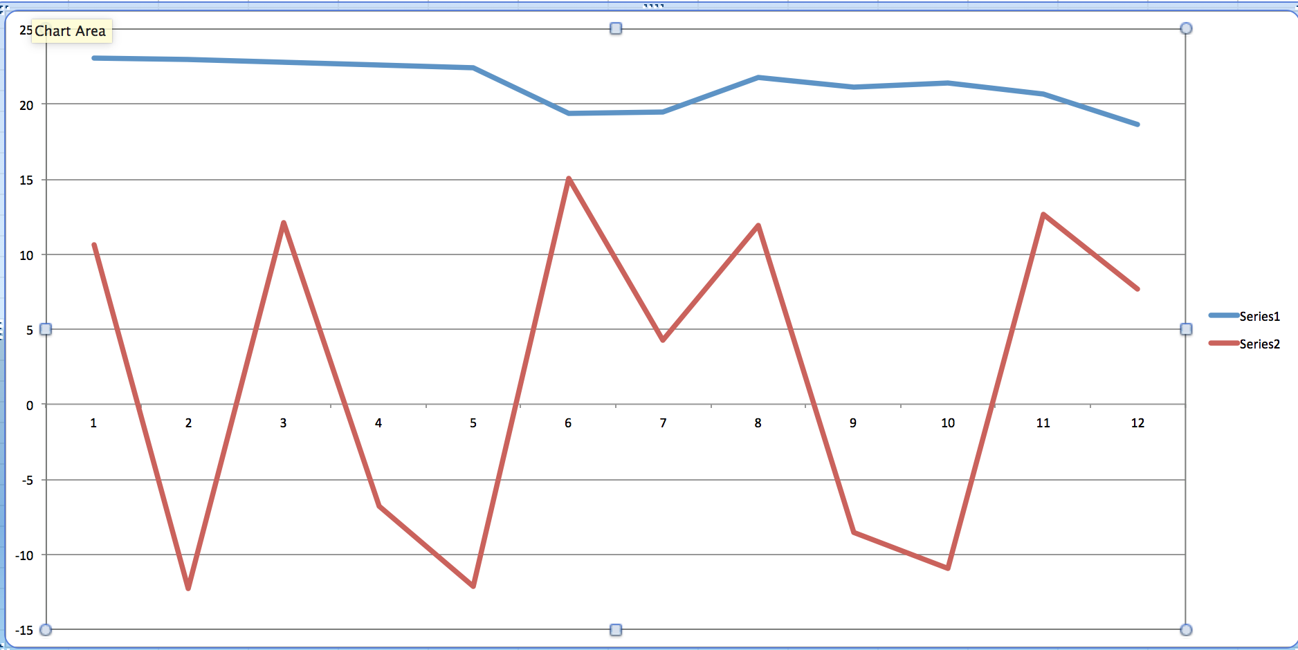

so ive been logging with evoscan and ive made this graph to see how my car is boosting.
A graph for Engine Load/RPM at WOTScreen Shot 2017-03-10 at 00.36.41.png
What could be the cause of my problem? i hear a rattling noise from my turbo, but i dont know if this is the timbre of a decat downpipe or is my turbo dodgy?
im hitting like 9.6psi at 3.4 k rpm, then my boost completey drops then shoots to 11psi then drops and shoots.

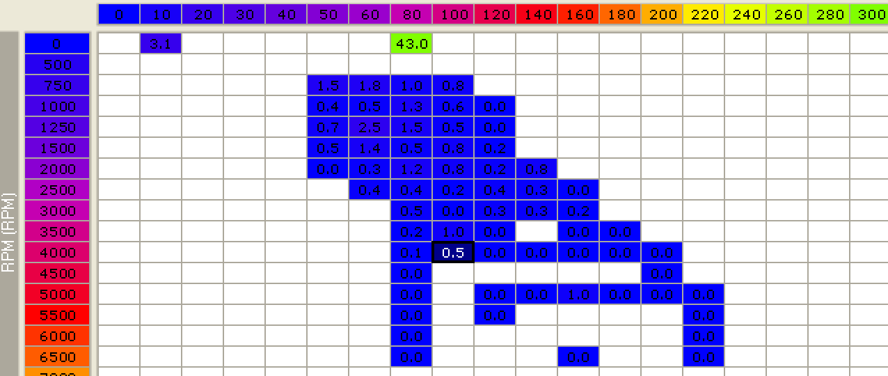

this was the wastegate at stock position:

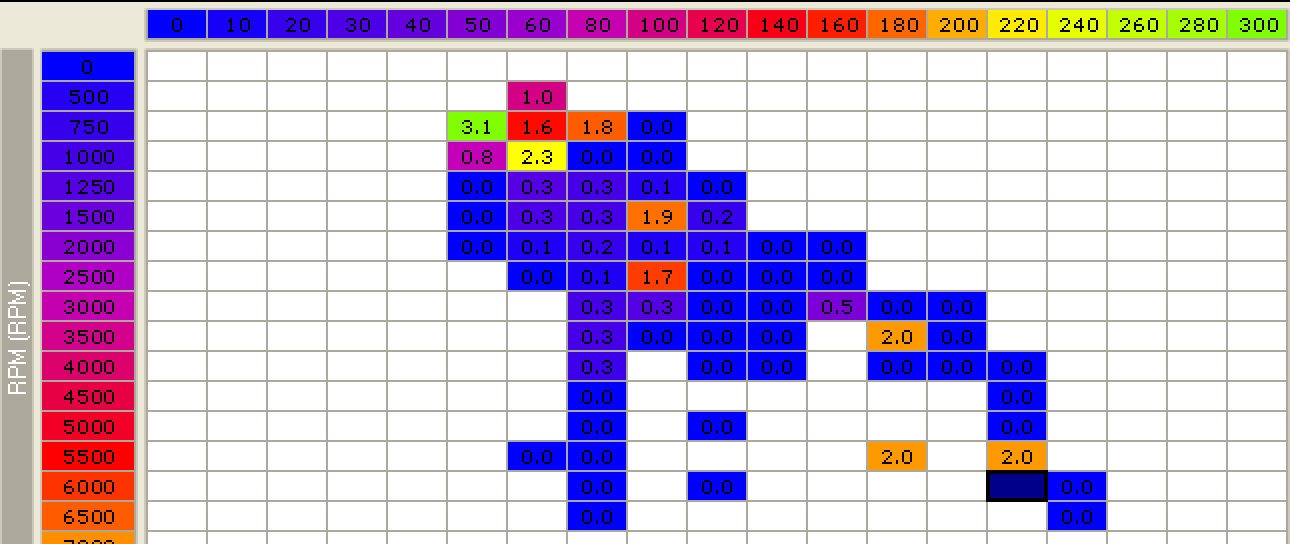

Screen Shot 2017-03-10 at 09.40.01.pngScreen Shot 2017-03-10 at 09.40.01.png

that first pic is the solinoid duty map and not the boost curve obviously ?

the first pic is engine load vs relative manifold pressure.

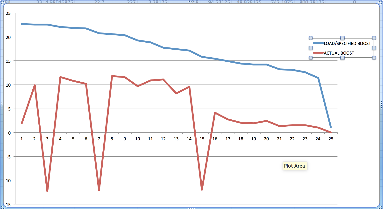

the manifold relative pressure will be all over the place.
-0.8, -0.6 , 0.2, 0.4 0.9 -0.8, -0.8, 0.9
this is all under WOT
and respectively the boost solenoid cyclce will be
0% when i loose all my boost (-0.8) under WOT.
