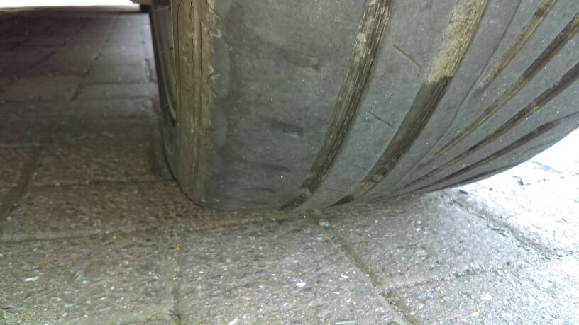

The old WRX has recently started wearing the inner most edge of the rear tyres on both sides. I know it's quite recent because I have had the wheels off often over the past 6 months. Is this a sign of any particular bush giving out? The tracking was checked a few months ago and was spot on supposedly. The fronts look fine.IMAG0980.jpg

I had the same problem with worn out springs replaced the springs and all good now
Just asked as it looks like camber wear and lowering throws the camber out and the rear camber can't be adjusted .
Unsure if the rear control arm or lateral link bushes being worn would throw out the castor enough to cause wear but they might be worth checking
When my springs where getting a bit tired it looked like it had been lowered so it could be just that
Any idea what the tyre to wheel arch gap should be?
I've had a look at the trailing arms. I can twist them but can't move them in any other direction.

Anyway OP do you have the oem wheels on or gone to a bigger size ? How often do you check the tyre pressures & what do you have in them ? Any one of many things cam cause un even wear but 90% of the time it's incorrect pressures or an alignment issue ?
Hi Stants. I check pressures every 2 weeks and set them to 2.2 Bar at the back.
Fair do's
you changed the droplinks or arb at all ?
Have you started carrying more wieght around
Yes I fitted new drop links not long.
Updated ones or plastic ? May be worth getting an alignment check as the uprated ones are stiffer so may alter the geo slightly
Will do. They are uprated.
Well I had it laser tracked yesterday. Apparently nothing wrong with the rear. Adjusted the front tracking a bit. When I put new tyres on the rear, I'll keep a close eye on it. The gap between tyre and wheel arch looks OK.
