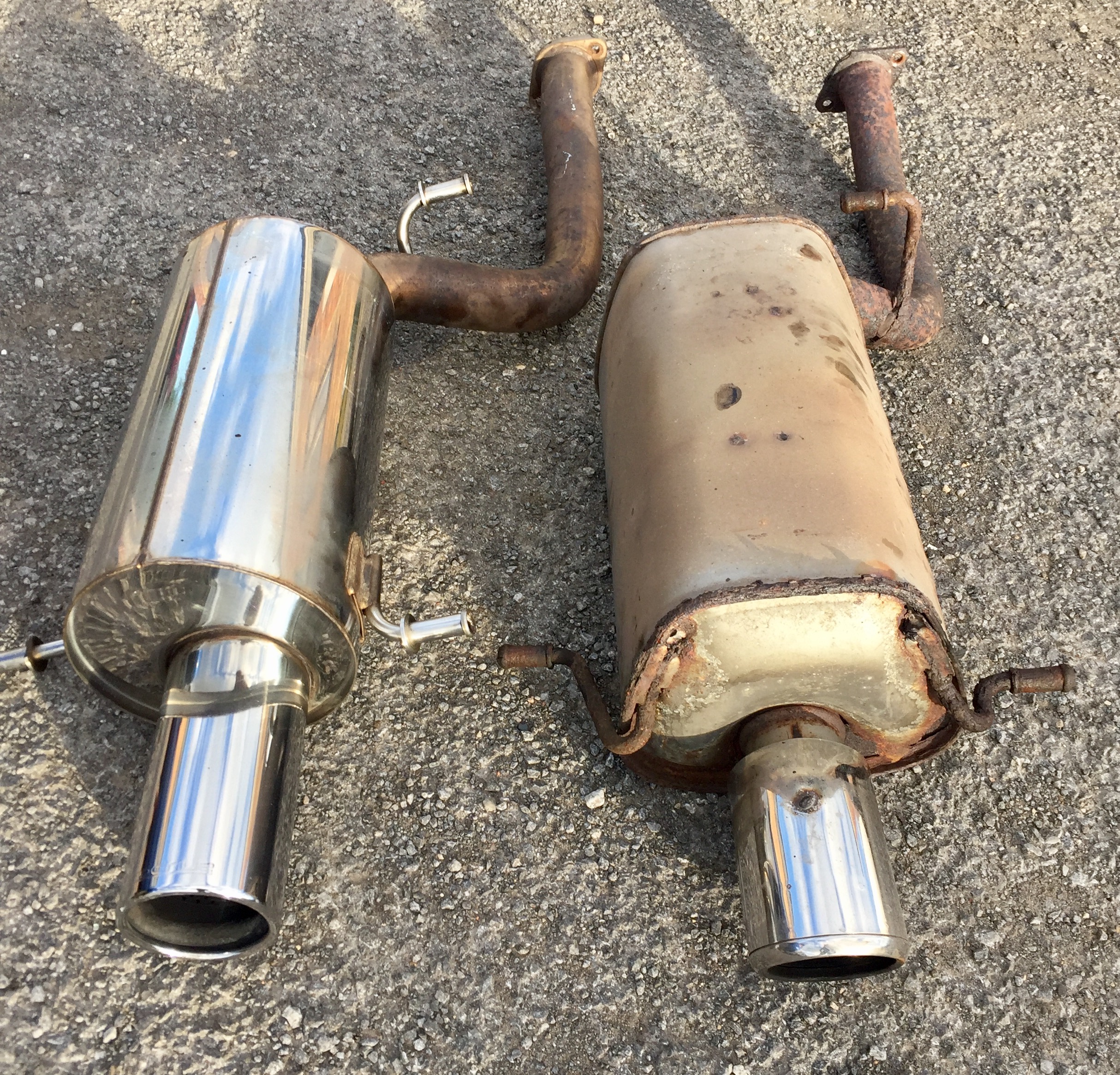

Yeah mine too. The downpipe and small cat pipe look like there in really good condition, but my centre pipe and backbox were quite corroded. Got the shiney prodrive one to replace the sti one, now just on the lookout for a stainless de-resonated centre pipe.  I've seen them on eBay for £89 but unsure what the quality will be like.
Pic of my old sti exhaust and prodrive one.
