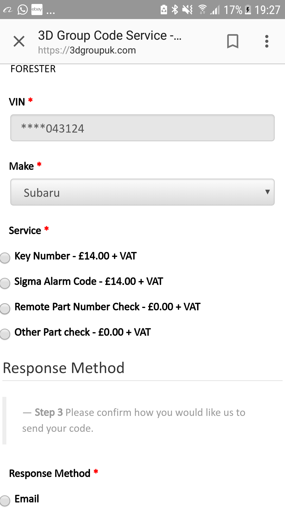

Two days in of owning new car and I've lost the only key good and proper.
If I get key code and sigma alarm code buy fob and program it would this work? Got option of paying lad £70 labour plus parts otherwise.
