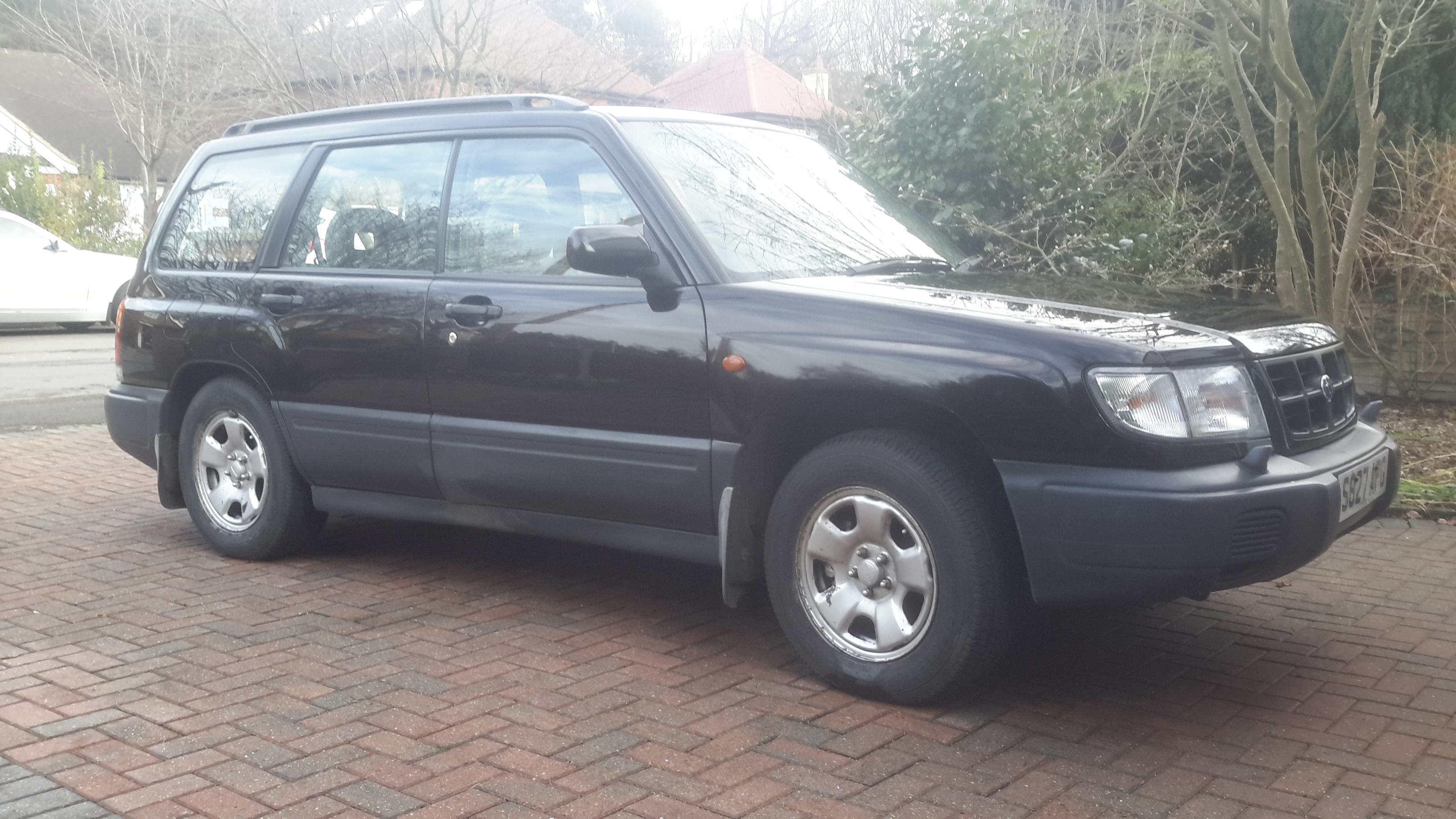

As you may notice from the pic, we have a sagging butt, and that is with coil assistors fitted, so next major purchase will be some ezyfit suspension units.

Use kyb struts and suplex springs and it cost about £210
use kyb springs and it about £260
kyb struts

Easy job if drop link bolts not rusted mess and brake lines separate and reusable .
Will make huge difference to ride and handling as yours totally collapsed .
looks tidy for a 98, have fun with your classic station wagon  ...
