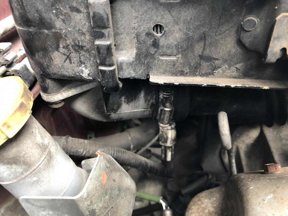

So, I went out driving today and after about 3 minutes of definitely having boost (the vta dv was ‘chavving’ at me) I then didn’t have any boost. No warning no funny noises no smoke or engine light. Just no boost/turbo. I had a quick look but it all looks an engine to me. I’ve had a quick look at all the hose they seem ok but without taking them off I suppose it’s hard to see.

Check the hose coming from your turbo to your intercooler and between the intercooler and throttle body. Would also have a look at the turbo actuator in case a vac line has come off
Ok just checked all the hose and everything appears connected with no splits or anything. Took the intercooler off looked all good to me and had the air box off just to look. Everything appears ok.
Drove it again to test and no change. I definitely think the turbo isn’t spooling up rather than a boost leak.
