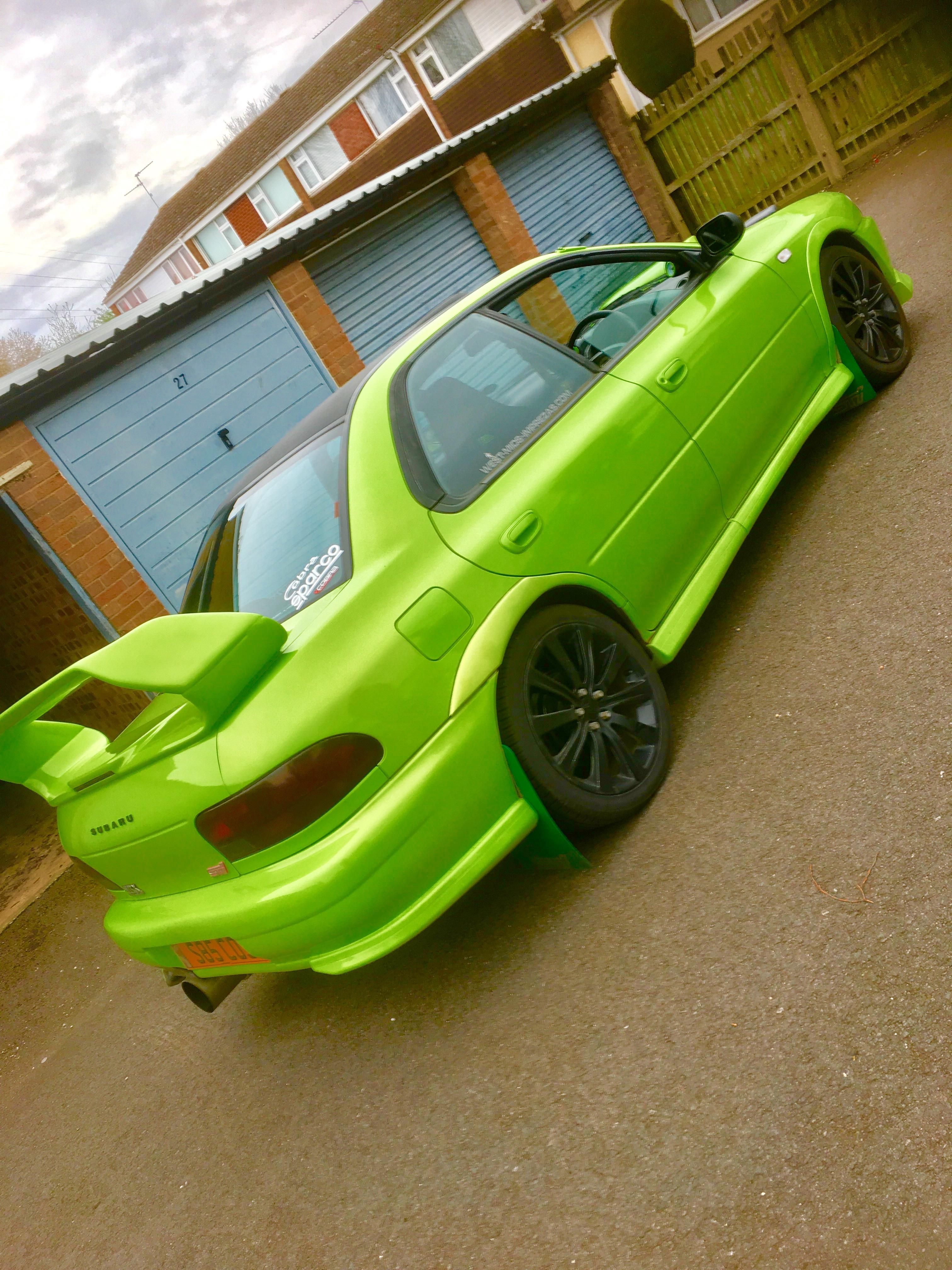

Me and my partner have got a 1998 Suburu Impreza wrx  we have a problem with our boot and was wondering how to take the boot lever cover off where the fuel cap leaver is as well  trying to get to the cable to see of it's come out holder  any recommendations are welcome thanks
