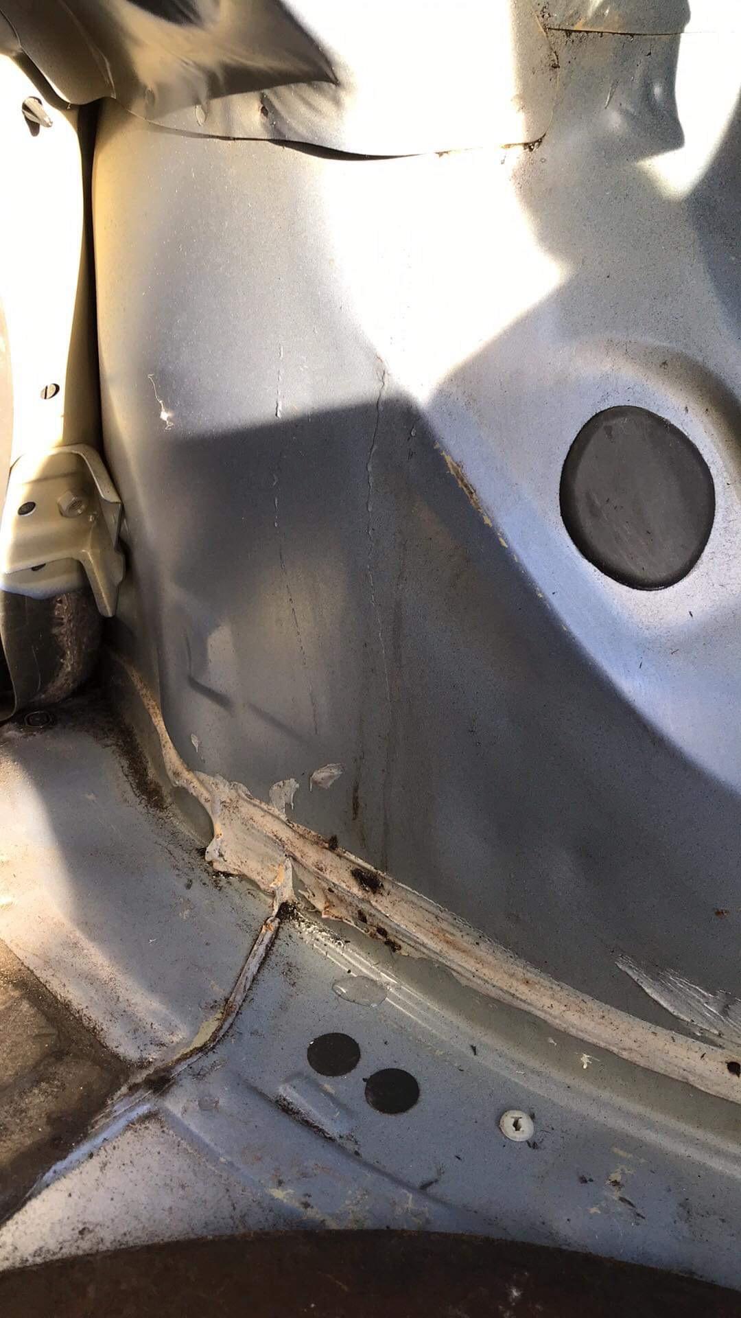

I too have a boot leak problem and it’s driving me insane.
The rubber seal is new and there is not leak from the spoiler.
I have attached where water seems to be coming in from.
Inhave noticed the seatbelt in the rear is also sometimes damp... where is the water getting in?

Did you ever find the cause of the leak?
I've recently noticed a leak in mine and it seems to be coming from the seam in the picture below where the rear wing meet the bottom of the rear window.
I'm thinking just clean it and put a little sealant in the gap.7eb3308f1cee9a67439d547ebb3d176f.jpg67318e4abe3d1cb4b7cf57ab3a1b6ece.jpg
