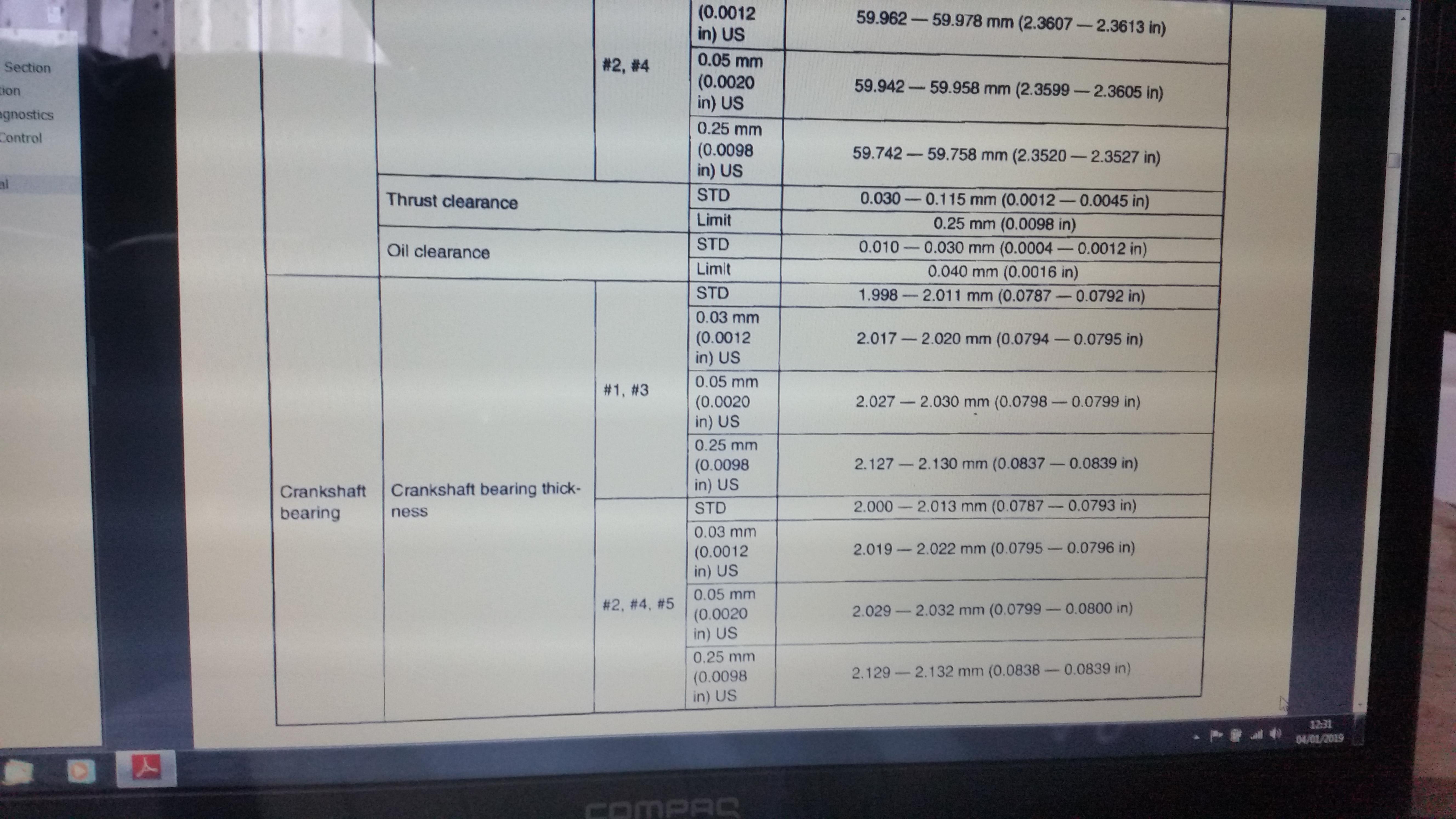

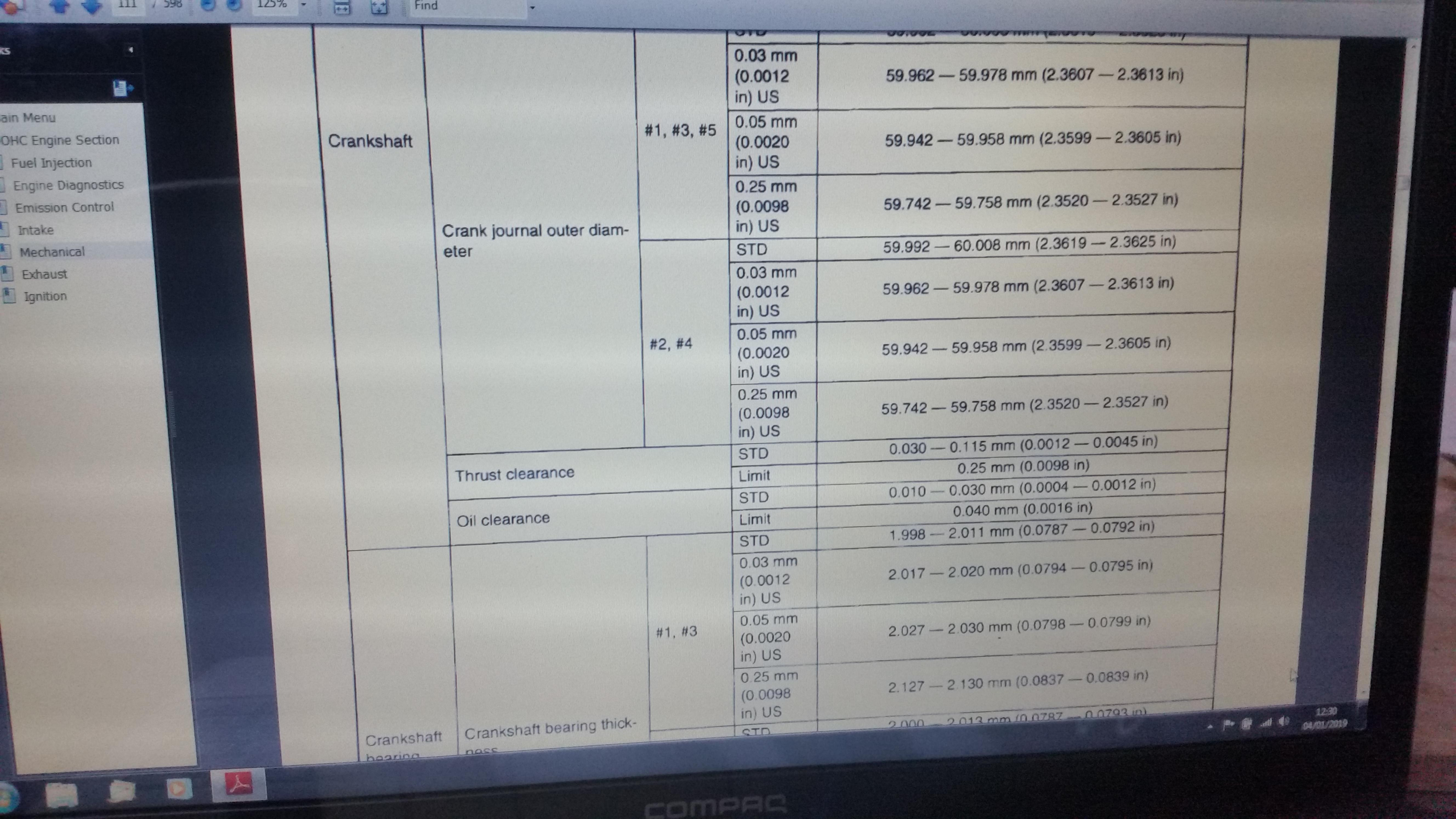

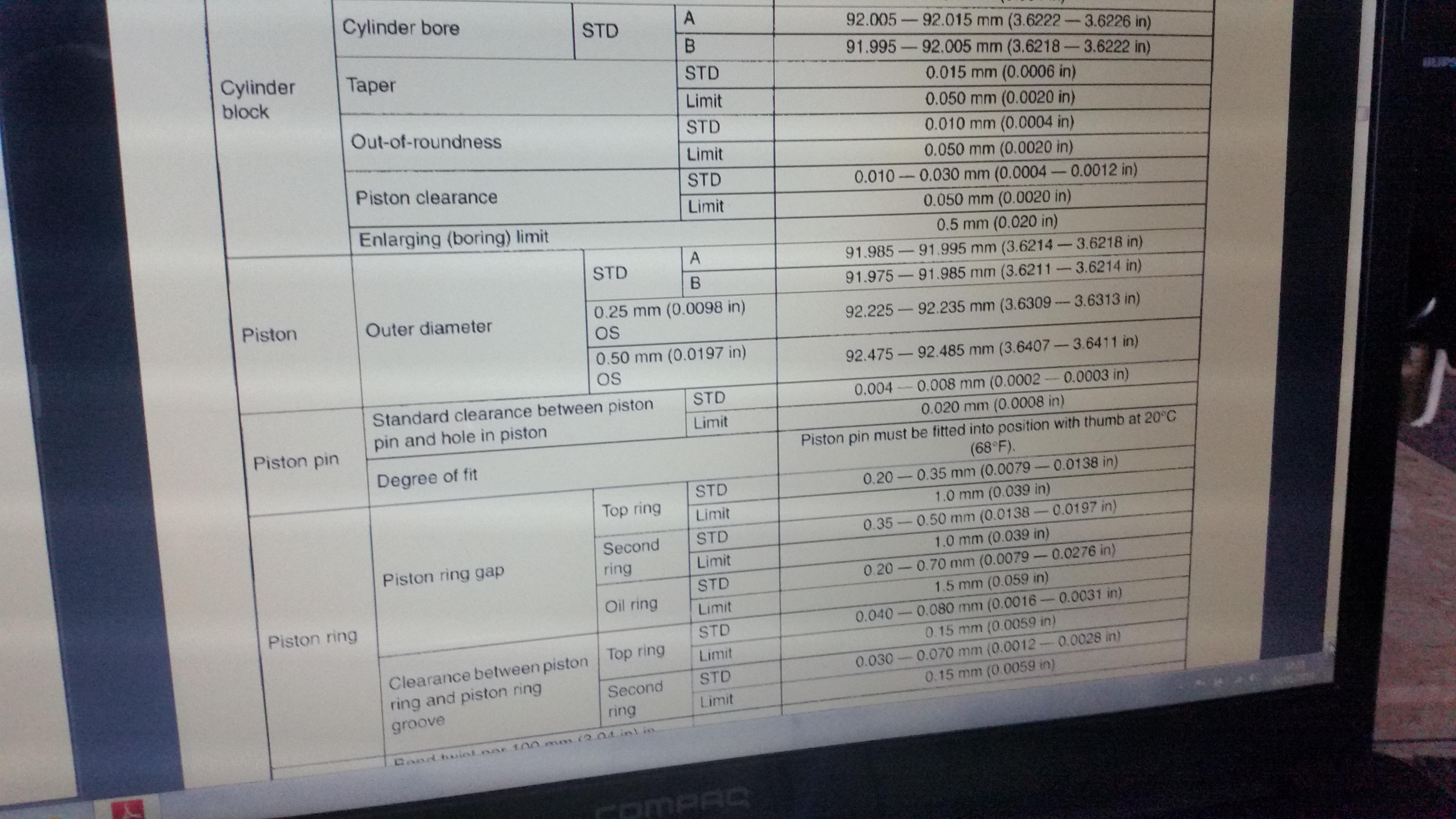

I’m currently rebuilding the motor for my gc8 Impreza but have run into problems finding a workshop manual, I need the clearances and tolerance limits for the votes, bearings, rings and pistons but cannot find them anywhere, can anybody help me? I’d appreciate it!!

Hi, I have seen some bits like this but am unsure if it still applies to my engine or not, anyway to tell? Cheers!
Hi mate, mine is a v3/v4 EJ20G & thanks for the specs mate!
