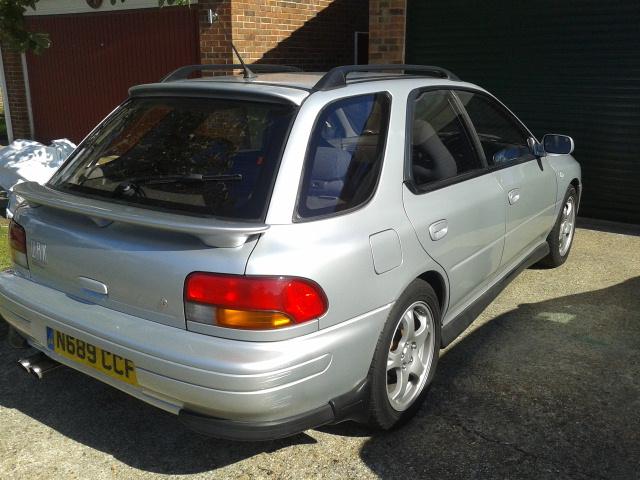

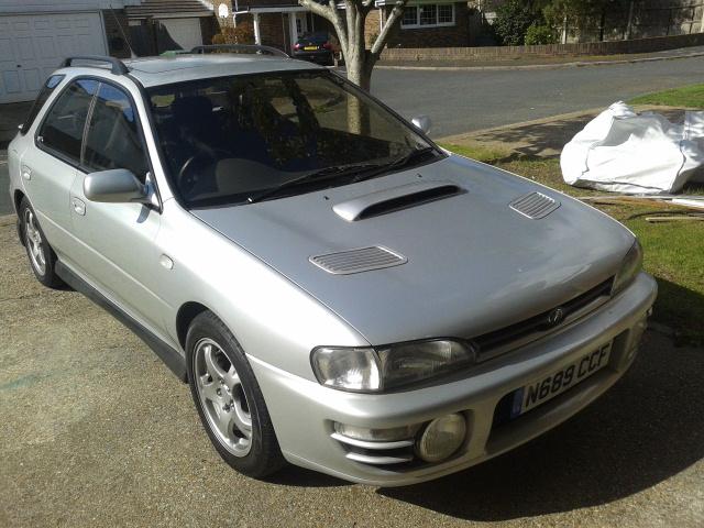

Hi new here Bought first subaru today a 96 impreza wrx estate (import).
its got a few things wrong though it cruises beautifully, it seems to missfire badly under heavy acceleration(???) hopefully nothing serious would be a shame if its destined for scrap already.
Still, its awesome regardless of problems
