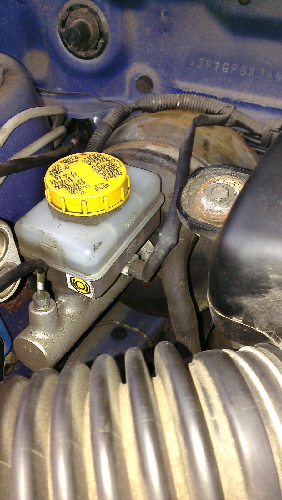

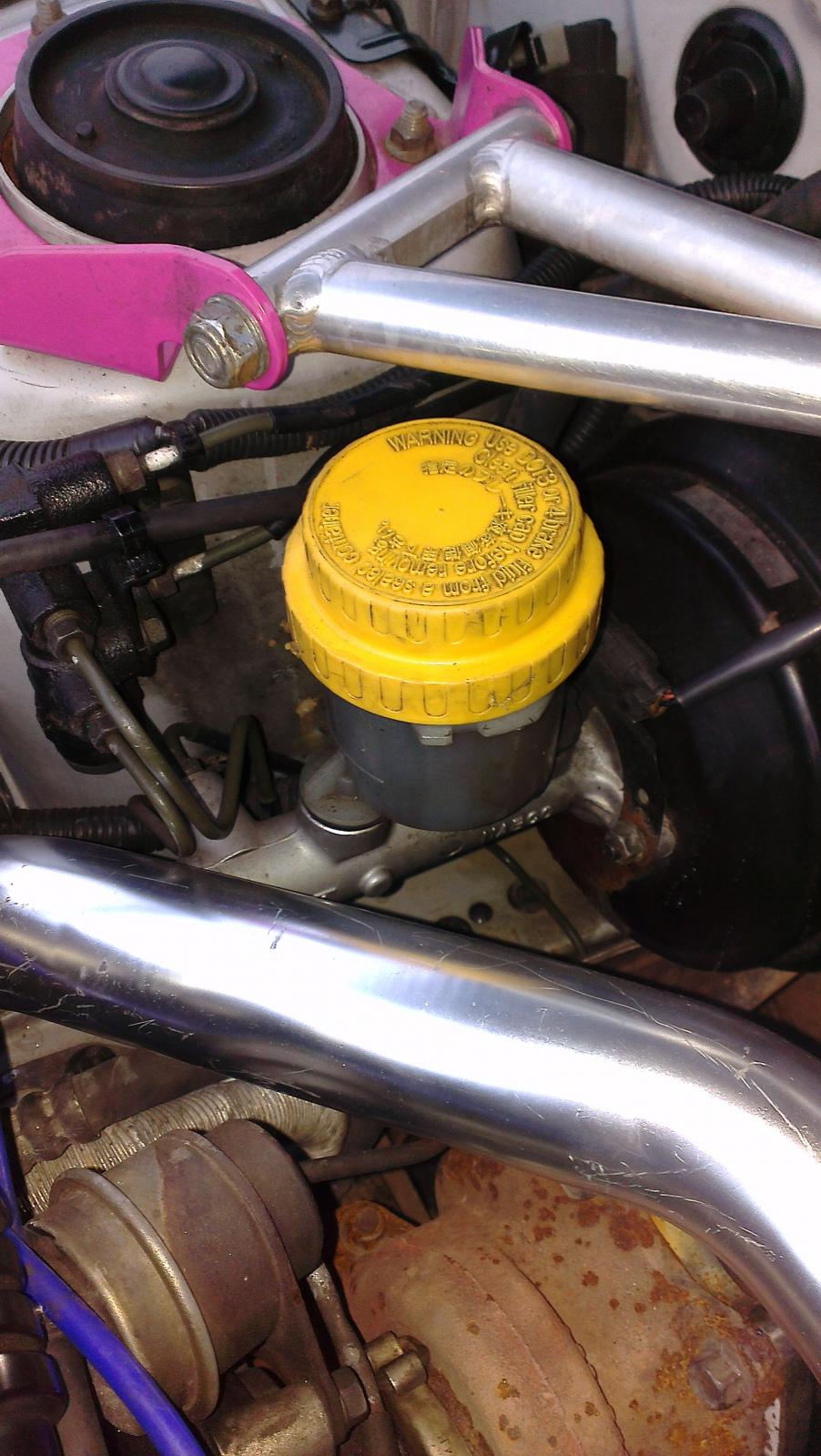

Photos...one on the left is the non turbo

i'm not sure on the master cylinder now after seeing them pics, ones i have done in the past from cable clutch and hydro clutch nave been identical in shape and pipe position bar the extra pipe in front of the brake pipe for the hydro clutch, i don't want to say go for it in case it's wrong, call Brian at Cams and he should be able to advise whats best
