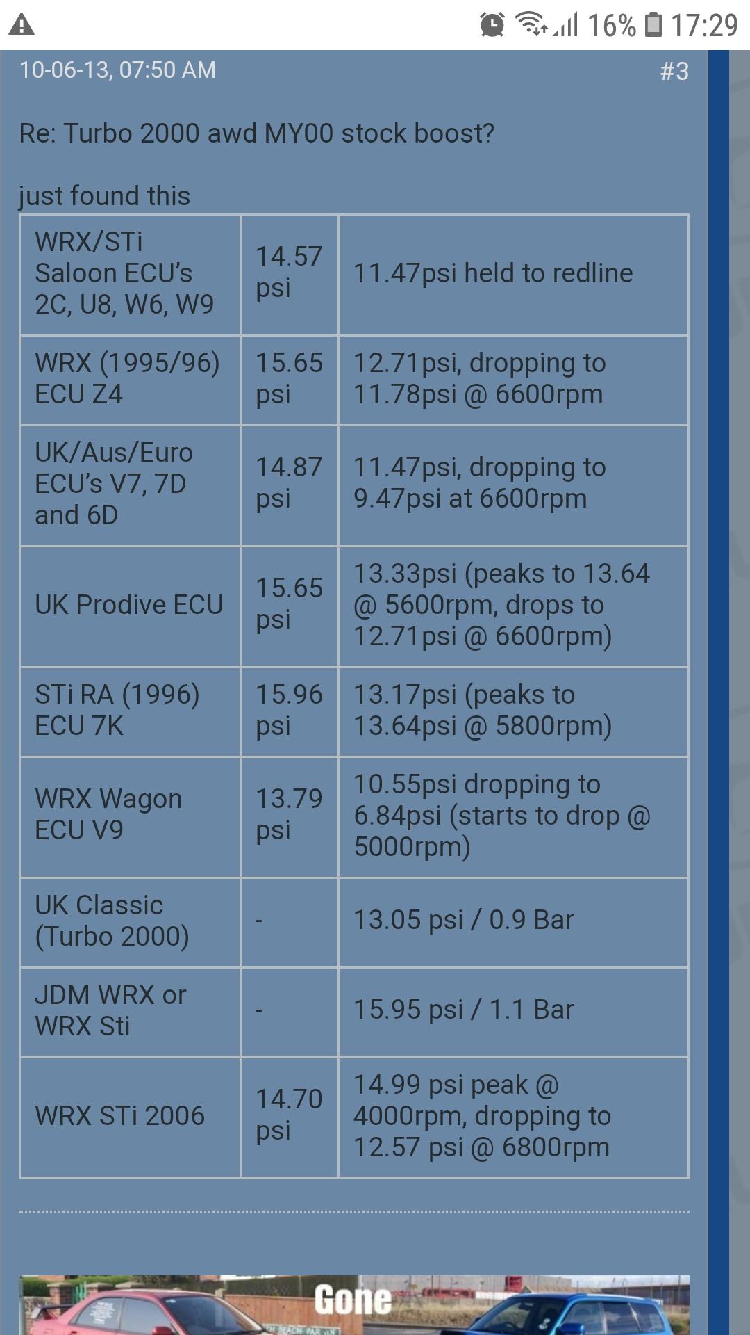

standard is 0.9 bar
Not too sure if that chart applies to your model , as it says my 00 at the top and no year difference on the UK turbo section ? .
Some of the sti and other model ECU numbers don't look right to me either but I could be wrong .
Was fairly sure my old UK v3 ran 0.6 bar before I had it mapped with a esl daughter board up to 1.4 bar (265 hp) but that was almost 10 yrs ago lol .
