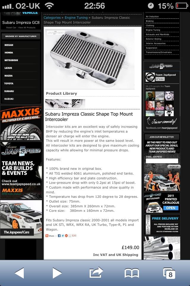

I have a classic impreza 2000 awd. Want to upgrade intercooler(not front mount). Any recommendation's/ideas. Have found one on japspeed for £149?? Thanks

Seems like a good price. I know you can fit newage ones to classic shapes with a bit of work depends how good you are with some spanners or how much you want to do messing about. has your's got the angle inter cooler or flat/straight ?

I have been looking as well, just out of curiosity what power will you be running as standard is good for at least 300bhp depending on the condition ?, or if its a must have a look at getting an STI Top mount, this will involve some slight modding to the bracket as its slightly bigger.
Thanks for welcome and thoughts. I have the flat/straight intercooler. Not really looking to mess around to much, would prefer a straight swap if poss. Not looking for massive gains, just want upgrade as I go, so if I do get it remapped, everything is in place to deal with extra power etc. also don't have the knowledge to go messing around to much. Current in not in great condition! Thanks
