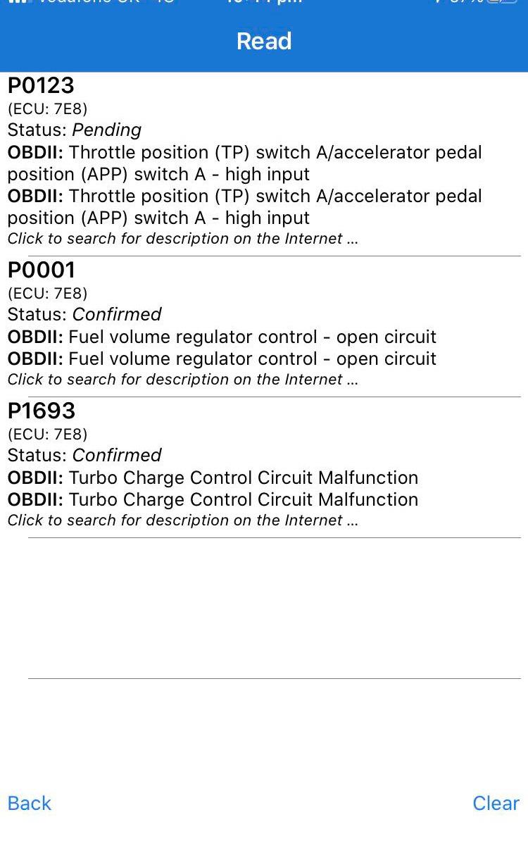

I have a 2004 Subaru Impreza witch I’ve been told has a misfire but just wondering what could be the problem I’ve tried spark plugs and ignition coil but still has the problem so I got a scanner for the car and it’s shows that this is the problem but Don’t know what this means

I had a similar problem with my car and it was down to the ignition leads being in there wrong places.
First thing is note the codes down and then clear them, then see if they come back on, they dont seem to point to a misfire. If you've changed plugs, leads, coil make sure you have firing order correct if so so try compression test
