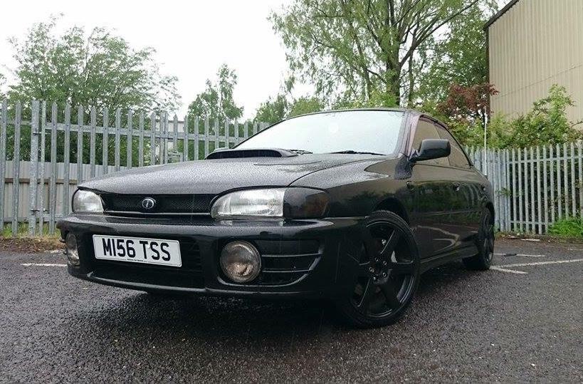

I have a nice clean black WRX 1995 JDM and want to upgrade the engine. I’m not really interested in big power. I just want it to look better and some minor mods then a re-map to take it over 300bhp. It’s currently about 275bhp. Here is what I was thinking of doing:

Welcome, i have a v1 wrx and to get up to over 300bhp you will need to fit bigger injectors, the original injectors should be grey 380cc i think which max out around 280bhp so will have to get a set of yellow 440cc which will allow you to get to over the 300 mark, i'm unsure about the newage intercooler mod as i've never done that but i'm sure you could get the v2 intercooler re-cored just like a radiator, samco make good quality hoses in all sorts of colours but not sure why some kits have 12 and others have 8 aux hoses, a panel filter will do for the power you are trying to achieve as cone filters are really for if you were going for silly power levels, hks, forge or gfb make decent dump valves and i have an esl board in my car fitted to a z4 ecu and all seems to be fine the engine still runs great and is producing around 300bhp with no problems at all so far 👍
