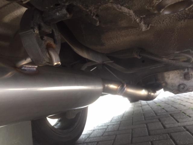

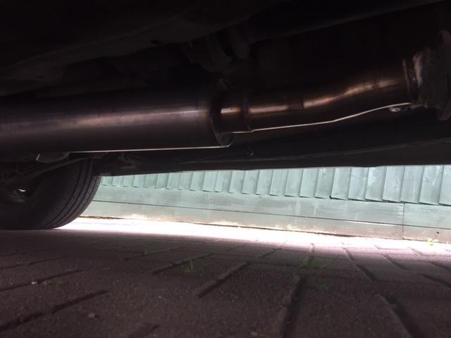

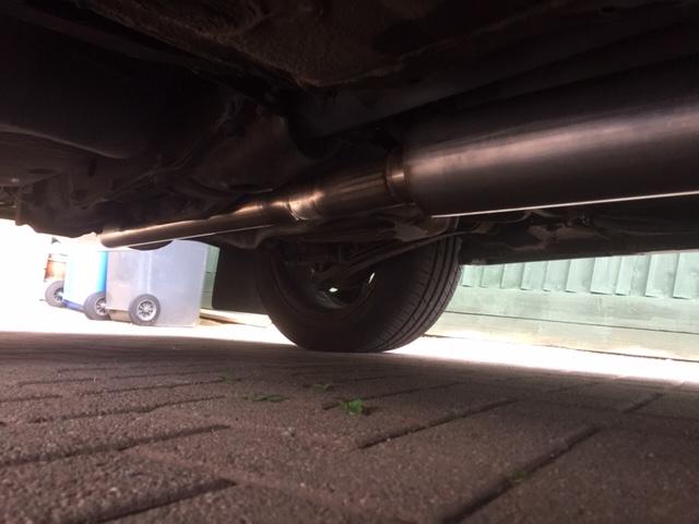

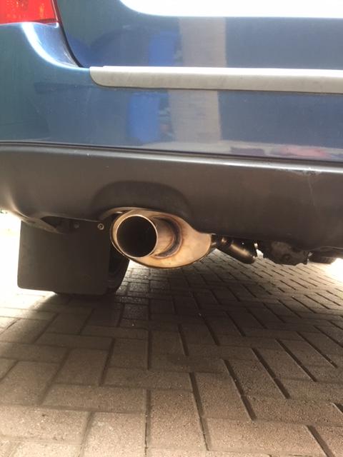

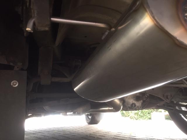

Well, the day went well, got there about 11.15 and the job was done by 1400, really pleased with the new exhaust, very good of them at MIJ to fit me in at such short notice, the last time we used MIJ it was a really long day, maybe they overbooked who knows, understandable though cos i bet they often get no shows but still got to pay their mechanics, certainly no complaints about today's rapid service.
Sounds slightly louder than OE but nothing to worry about, it now sounds like a proper Scooby which the OE exhaust didn't, kinda like it.
Cor flippen 'eck, me and phone cameras and PC's ain't happy bed fellows, if it wasn't for my endlessly understanding long suffering wifey there'd be no photos at all, my super duper Cat unbreakable phone takes brill pics but i can't seem to send them anywhere else in readable form, be back on box Brownie yet for pictures and pushing 4d in the red phone box and pushing button A to speak...i bet only a handful here knows what the hell i'm on about with button A.
Anyway, many thanks MrB, you couldn't have timed that better, i'd have been gutted to find a 2.0 litre NA mild steel exhaust had been supplied and fitted, and at higher cost than the stainless now in pride of place.
As you requested, price paid was £295 all inc (though i always leave a drink for the lads who actually do the job, old school see), lifetime warranty too.
Hope the pics come out ok, David Bailey i ain't.

Thinking about it, that's the same price i paid MIJ for the single system on the 2002 H6 Outback over 5 years ago.
As a bonus, filled up with LPG half a mile up the road from MIJ @ 45p per litre, yes a very good day all in.
Again thanks MrB for the timely advice, wish you were closer, haven't found any Subaru specialists locally for Northants yet.
Good job
well worth the trip and well worth 300quid .
their prices seem very good, although as specialise in this work they fast and materials cheaper in bulk and good knowledge of supply chain .
would of been a miserable result if had ended up with of the shelf NA mild steel system .
have fun with your XT and thank the wife for putting up with you and your phone 🙂 ...
