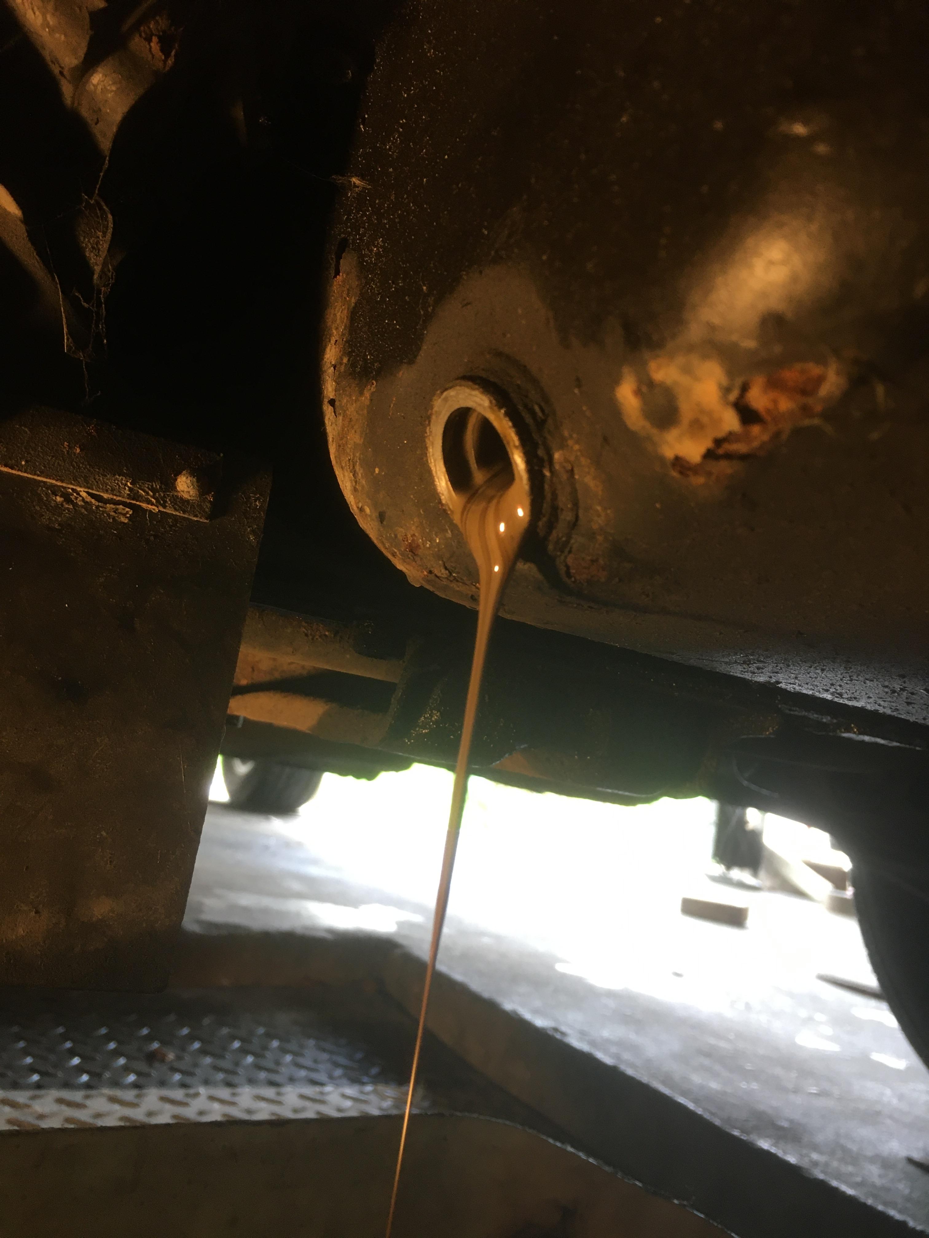

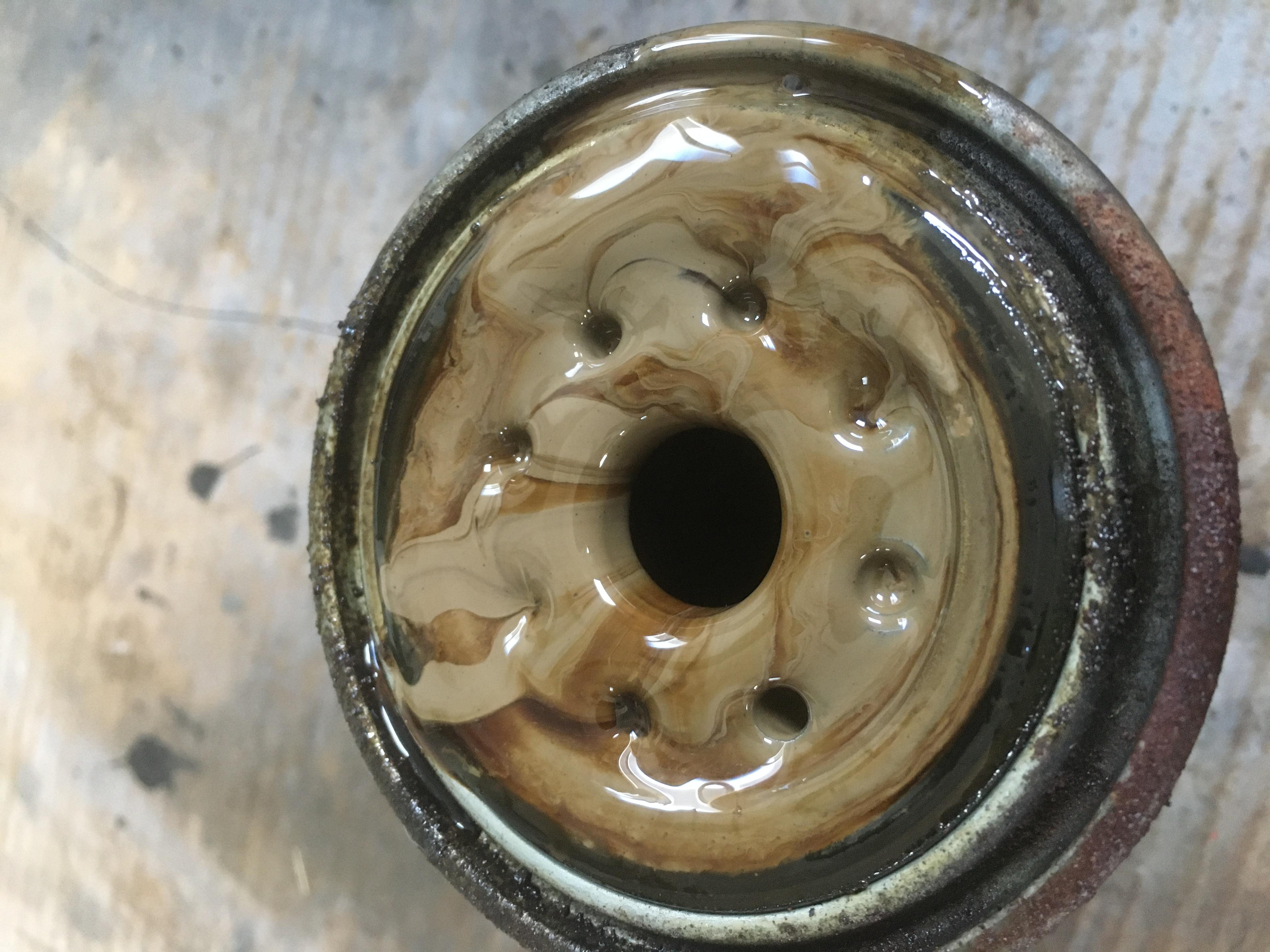

Once Iโ€™d removed the caliper and found the dust boot mullered I could roll it over the pit to drop the oil as it was way over the upper mark.
Thats when it got worse.
So I went for a pintย

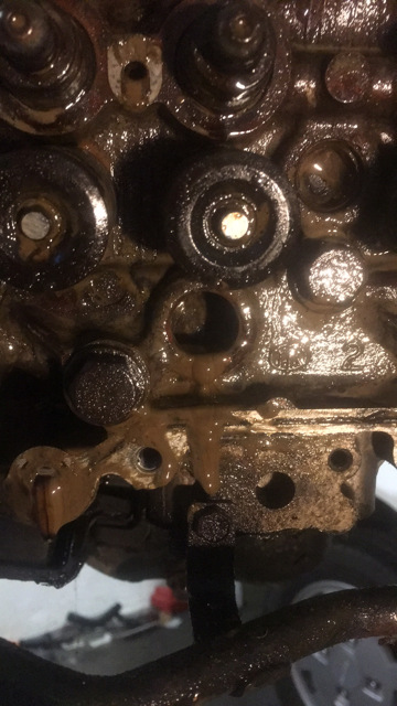

Went to pressure test the cooling system today and was a complete fail.
I put 5 litres of water in the rad and it ended up straight in the sump,
Guessing this is hopefully a gasket failure rather than a cracked head.
Will hopefully begin the strip down tomorrow

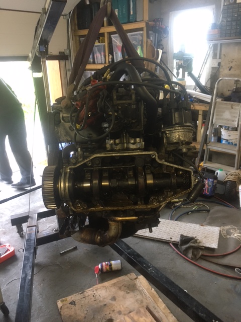

So I've decided to pull the engine out to give it a good check over,
Am considering just replacing the whole thing In one hit, but unsure what would go back in its place with the minimum of fettling.
Any ideas ???
ย
Second hand engine is just that, you may get a good one or you may get a bad one, if your planning on keeping the car I'd just bite the bullet and get it properly rebuilt,ย initial strip and assess will tell you what the current situation is and what's salvageable.

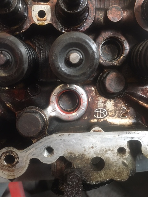

So I've found the culprit, it had spat a freeze plug in the RHS head.
Been replaced and gasket set arrived for the re assembly.

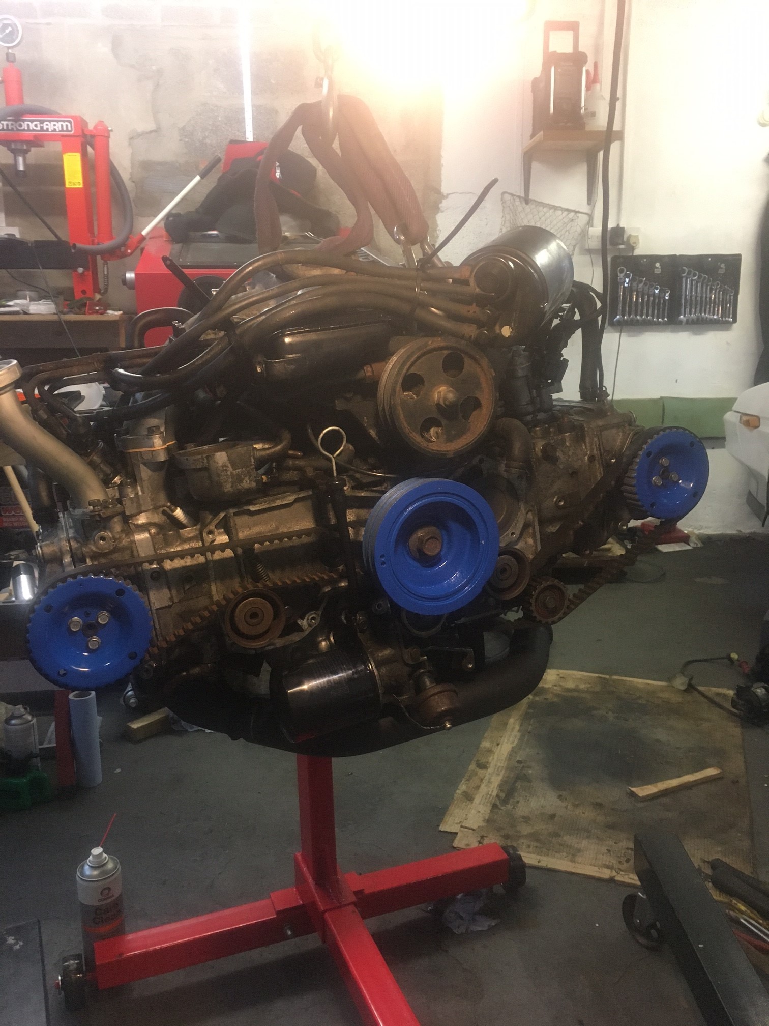

I've just rebuilt the oil pump and have cleaned just about all the oil galleries I can get to.
Sump is off with new paint drying. Plan is to refill with oil and spin pump with a cordless drill to prime system and blow through anyย  remaining sludge.
Once new seals have arrived fromย Japan I'll rebuild the cam towers, refit everything removed and drop the engine back in and fingers crossed.
