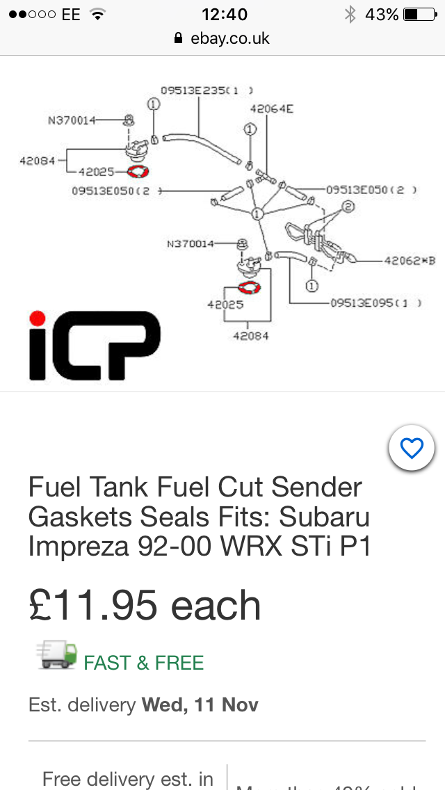

Finally, does anyone possibly know of a place to get a after market fuel pump sender for a 1995 impreza wrx.
What's different about them, because the fuel tanks are all the same. Or so I thought.🤔
Everything lists 92 - 00 for fuel stuff.
