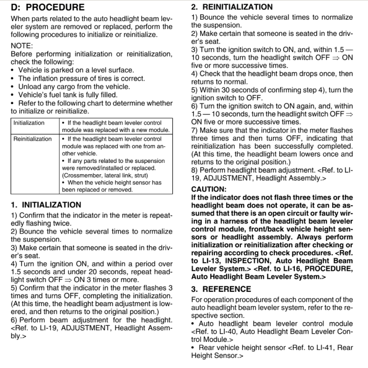

I have replaced level sensors both front and rear on my 2009 Subaru Impreza (UK) that has some auto leveling system.  I also had to repair/restore some arms holding the sensor in position. At the MOT the guys were trying to adjust the headlights as they were saying it was aiming too low but failed to adjust it saying it didn't want to do it. There is some adjustment screw at the back of the headlamp but seems like it doesn't lets you do any adjustment. Is there some special procedure to adjust the headlights? I've found something on the internet (attached) but it doesn't seem to work on my car. I'm guessing there has to be some way of programming/resetting that leveling system after a new sensors had been fitted.
Thanks.
Never mind :).
I tried again and with a bit more patience I could lift the headlights higher using the adjustment screws. The lights do auto calibrate somehow each time you move the adjustment screw which can make you feel somethings not right. Hopefully I can go for retest now 😅
