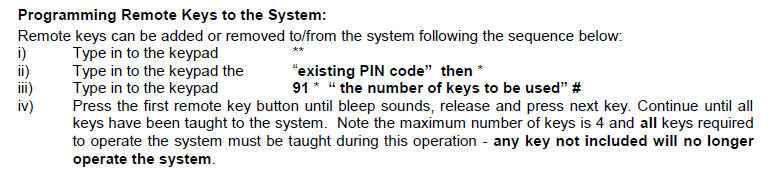

because it wrong procedure for Sigma system .
Follow what Greenmamba has posted as that correct and what we use .

Have you tried programming just one fob ?
and if that does not work try program procedure again with other fob .
Picking up a used fob or borrowing another fob for a test would be a fairly easy way forward in diagnosis .
