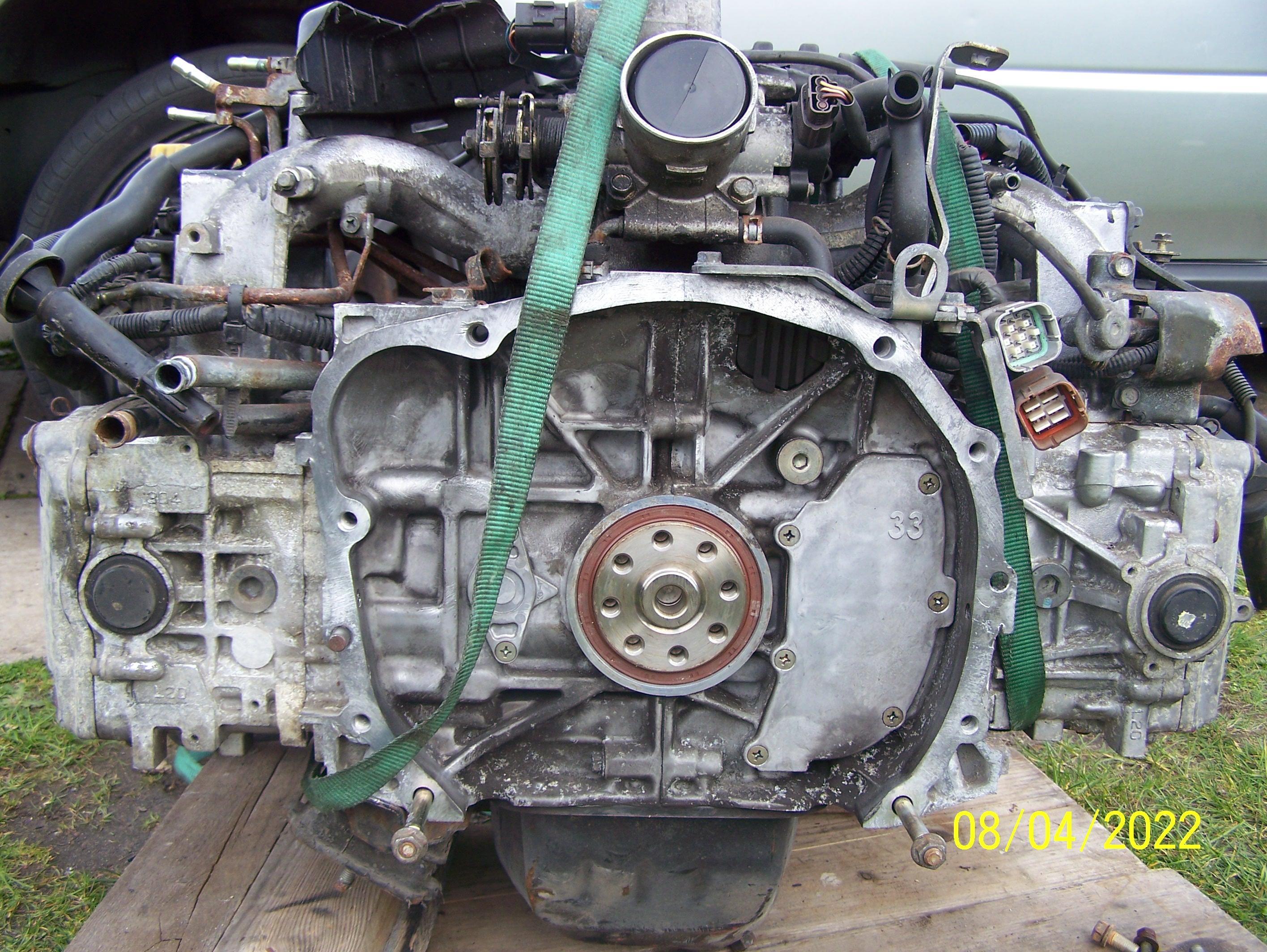

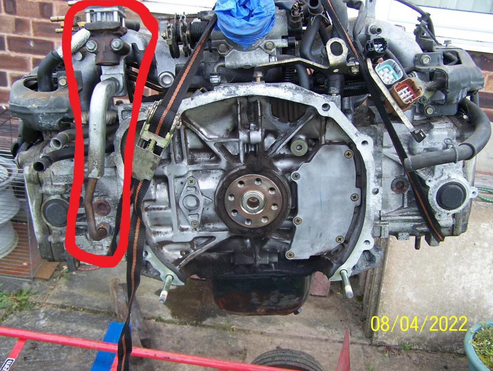

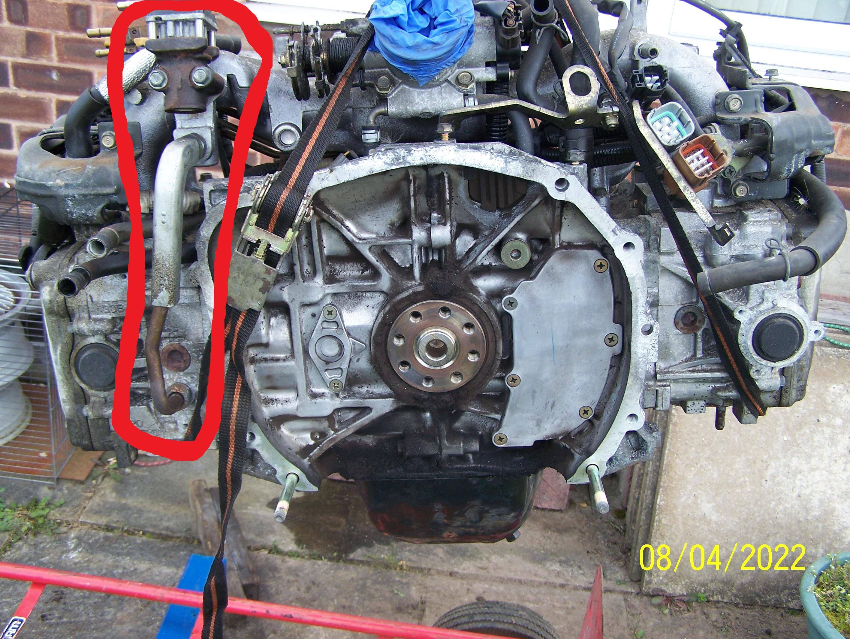

nictriumph Posted April 8 Report Share Posted April 8 help with engine change middle of changing engines due to worn crank,knocking!,owner has brought me a an engine to fit,,,,this picture shows original engine,,what is that thing in red circle? the replacement engine has not got one or hole to fit too thanks for now Quote Link to comment Share on other sites More sharing options...
nictriumph Posted April 8 Author Report Share Posted April 8 i know what is.....EGR control valve and pipe going to head from manifold can the replacement engine be converted to take egr pipe? what size is it and what drill bit size would i need? thanks nic Quote Link to comment Share on other sites More sharing options...
nictriumph Posted April 12 Author Report Share Posted April 12 replacement engine now sorted,,,drilled out in stages,8mm all the way thru and tap m20 thread down 17mm deep...just need to change over induction system Quote Link to comment Share on other sites More sharing options...

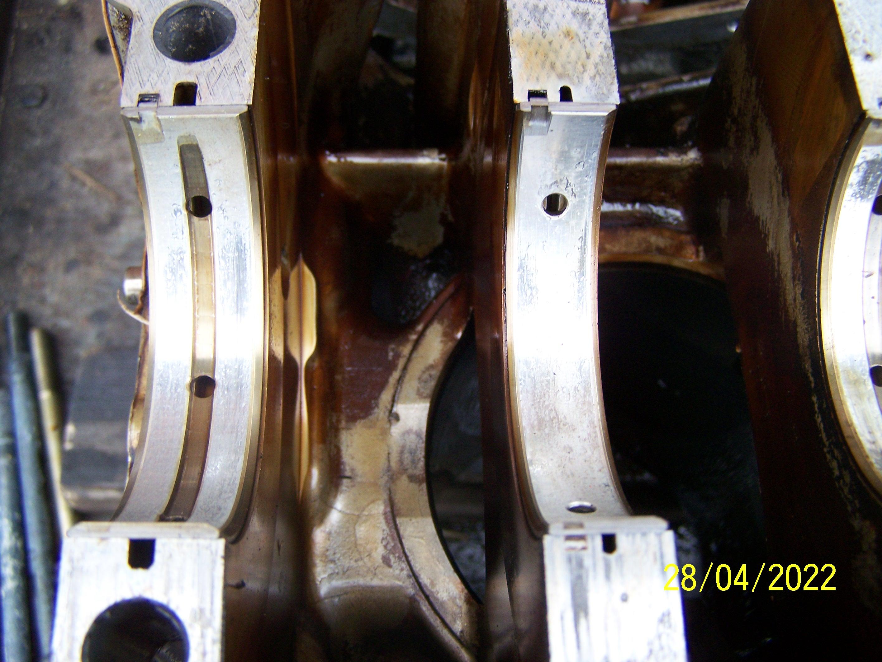

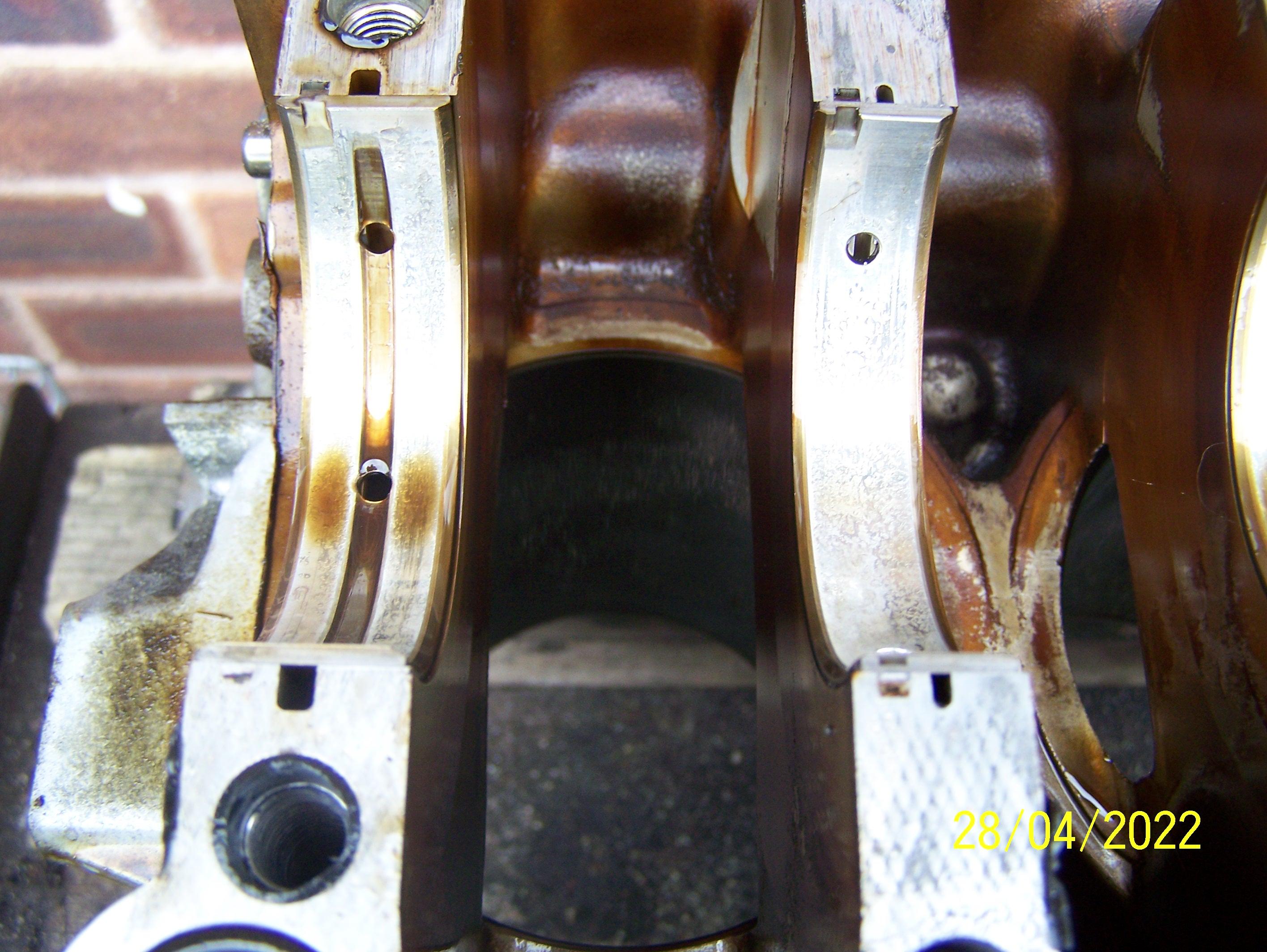

nictriumph Posted April 27 Author Report Share Posted April 27 started to have a look at old engine,,front left piston knocking from big end bearings,this is the only piston thats has the knock.......fingers crossed it has not touched the crank,hopefully its all good Quote Link to comment Share on other sites More sharing options...

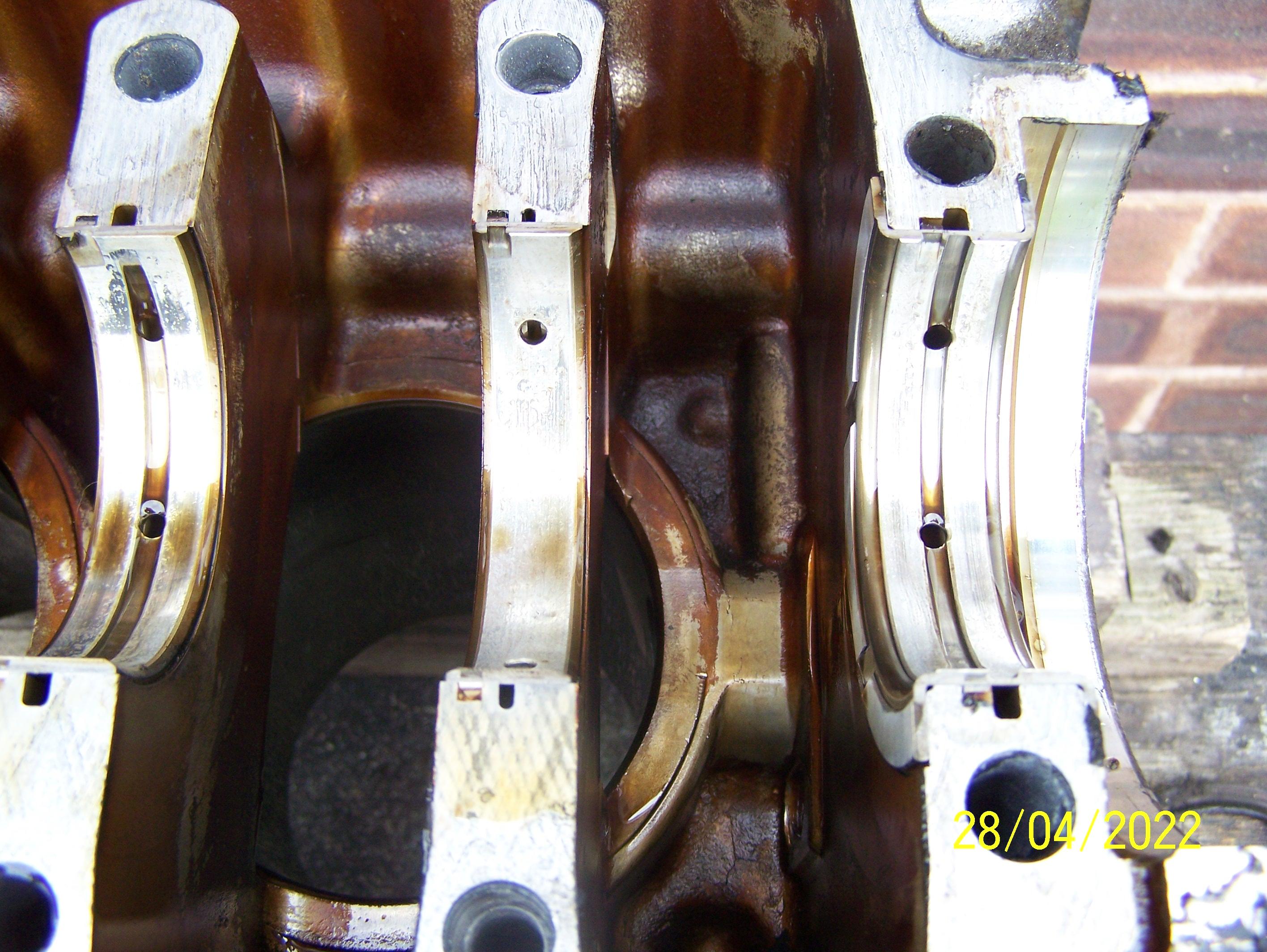

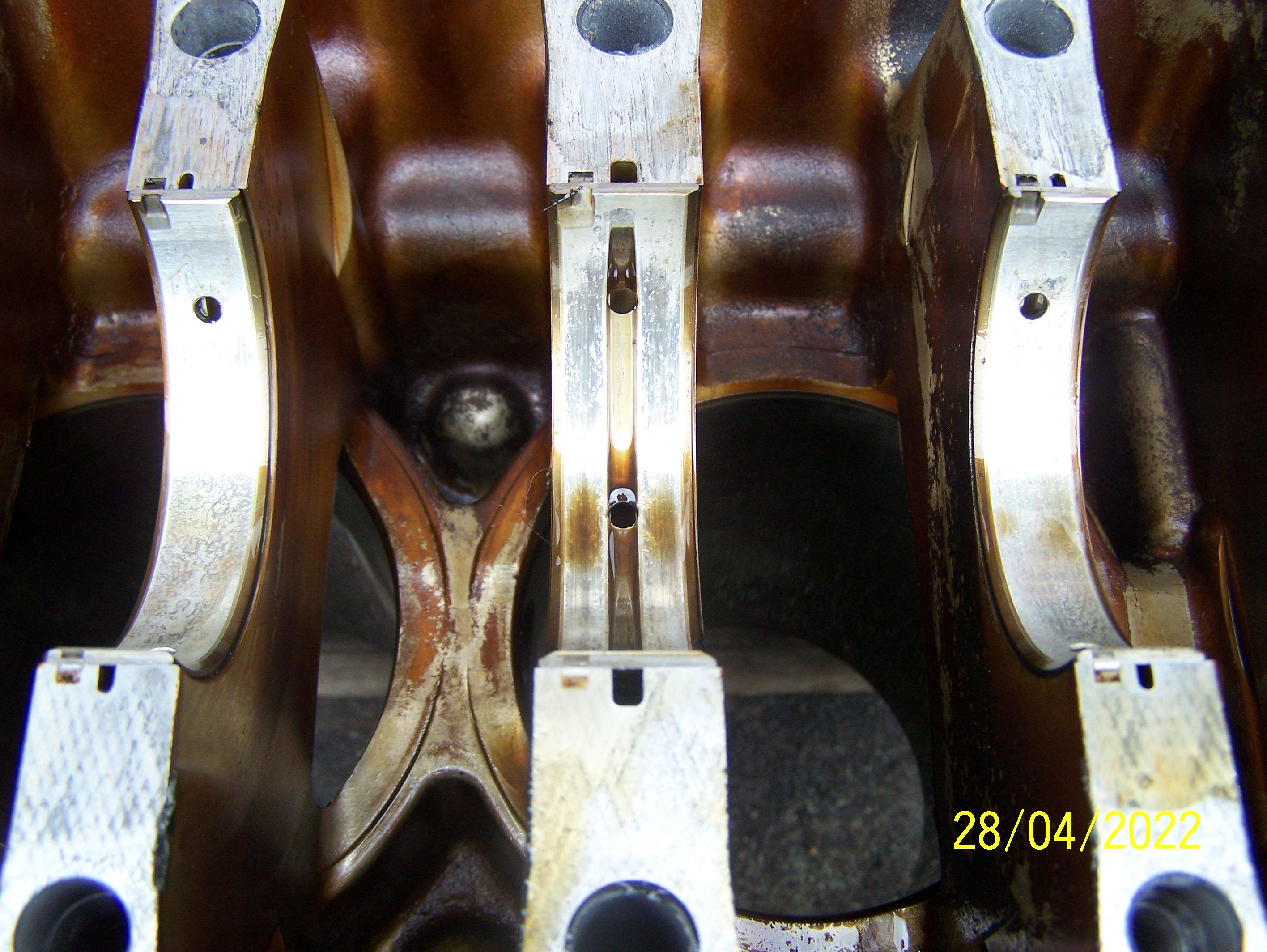

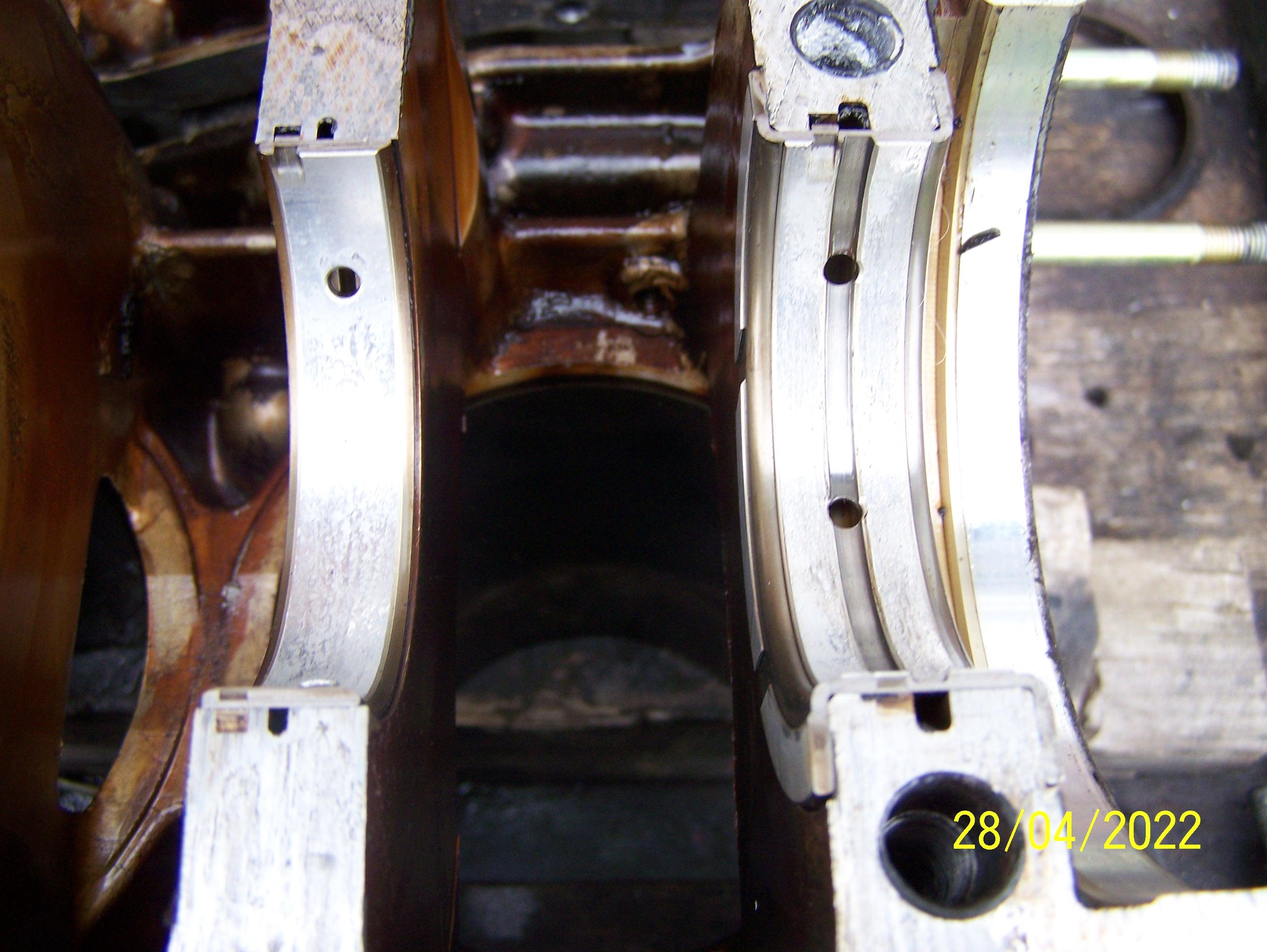

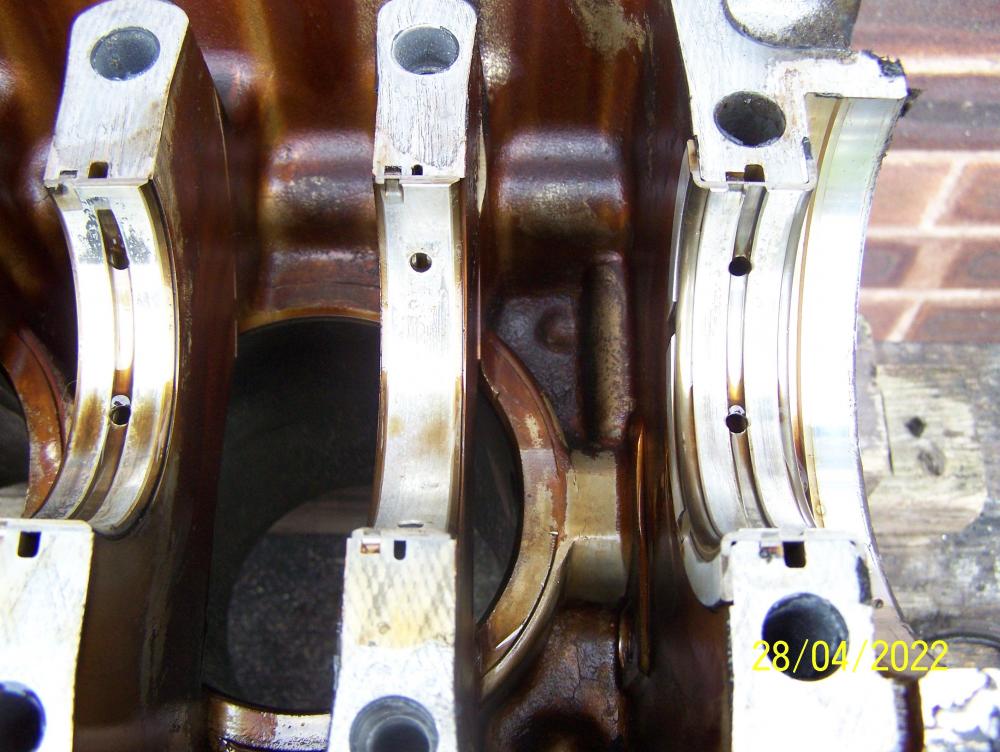

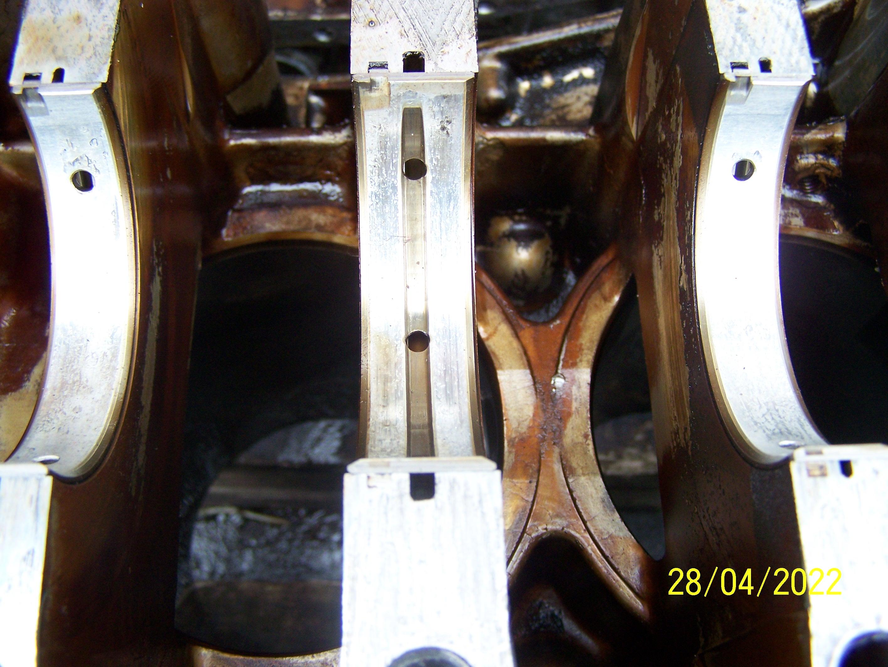

nictriumph Posted April 28 Author Report Share Posted April 28 well ive split the engine and front left piston bearing shells are gone,so full set of con rod bearings are needed,,,,not sure about the crank bearings....heres a few pictures of crank bearings....any ideas if they are still good to use? there was no play in crank before strip down Quote Link to comment Share on other sites More sharing options...
savage bulldogs Posted May 2 Report Share Posted May 2 I'd measure up the journals and see if they're in factory spec , If so I think a new set of stock shells are under £100 . Would be a shame to spend £1k+ on gaskets and a timing belt kit , just to end up with crank rumble 1 1 Quote Link to comment Share on other sites More sharing options...
nictriumph Posted May 2 Author Report Share Posted May 2 think your right there,after a good clean they look worse,will look out for new shells and conrod bearings...but will be put on back burner 1 Quote Link to comment Share on other sites More sharing options...
