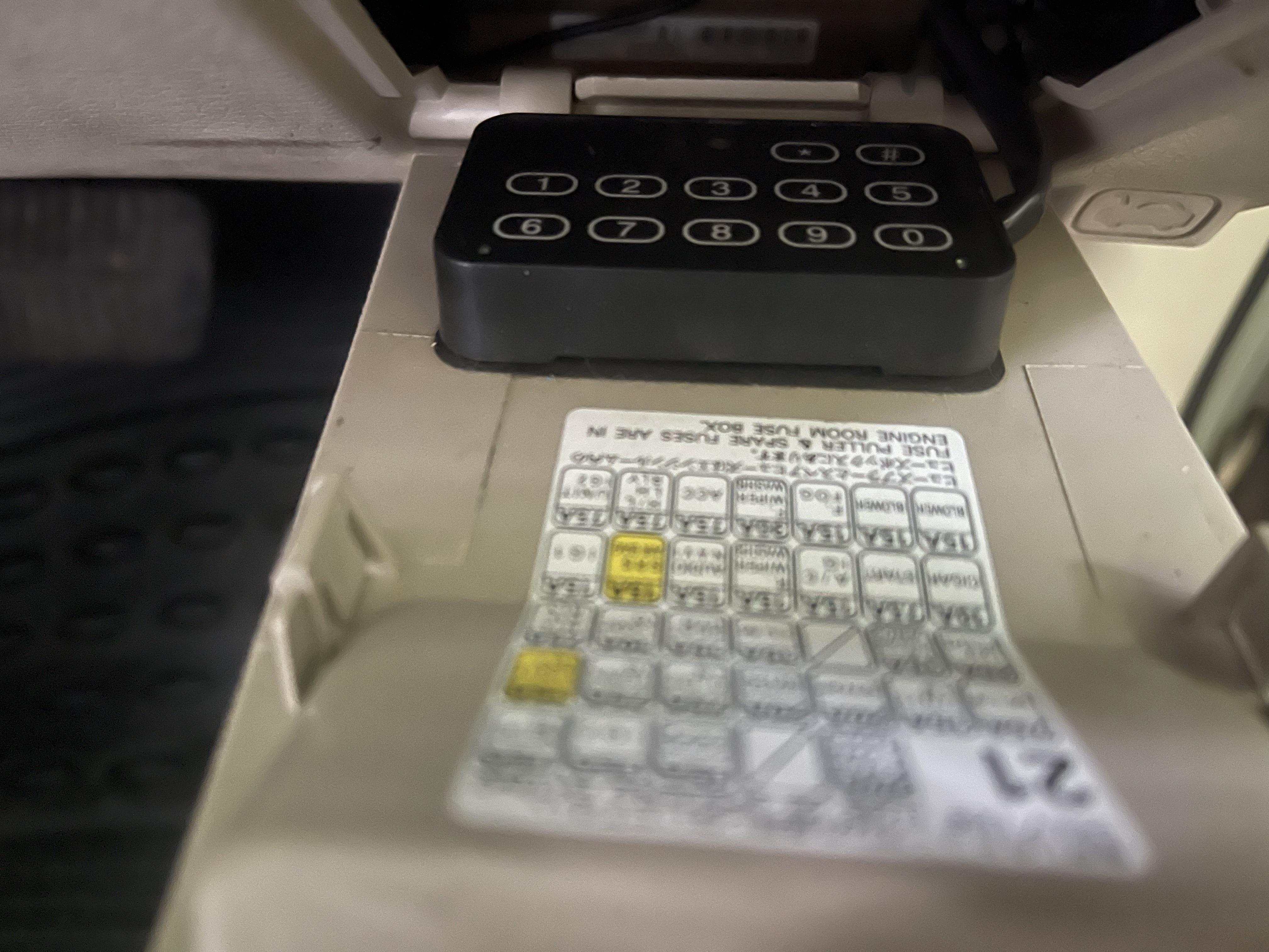

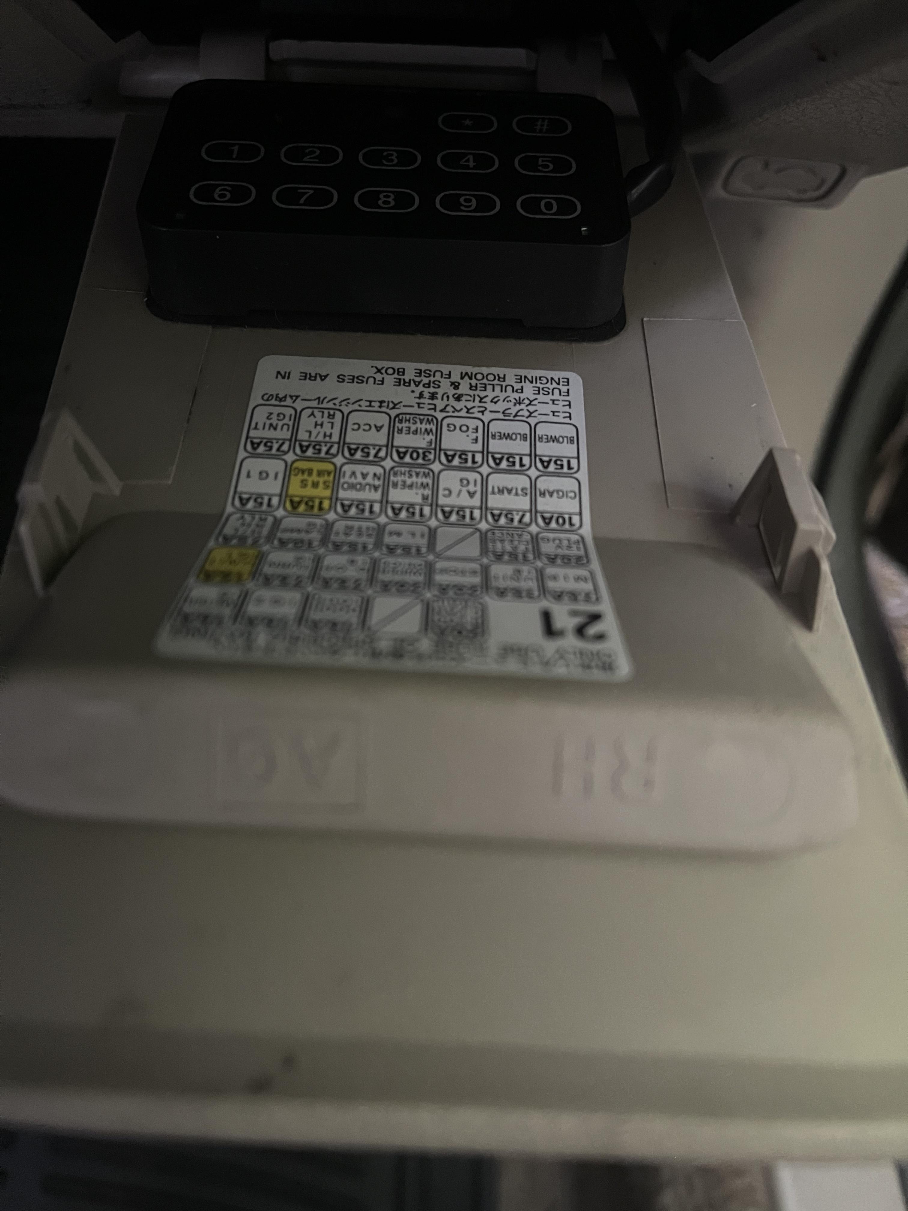

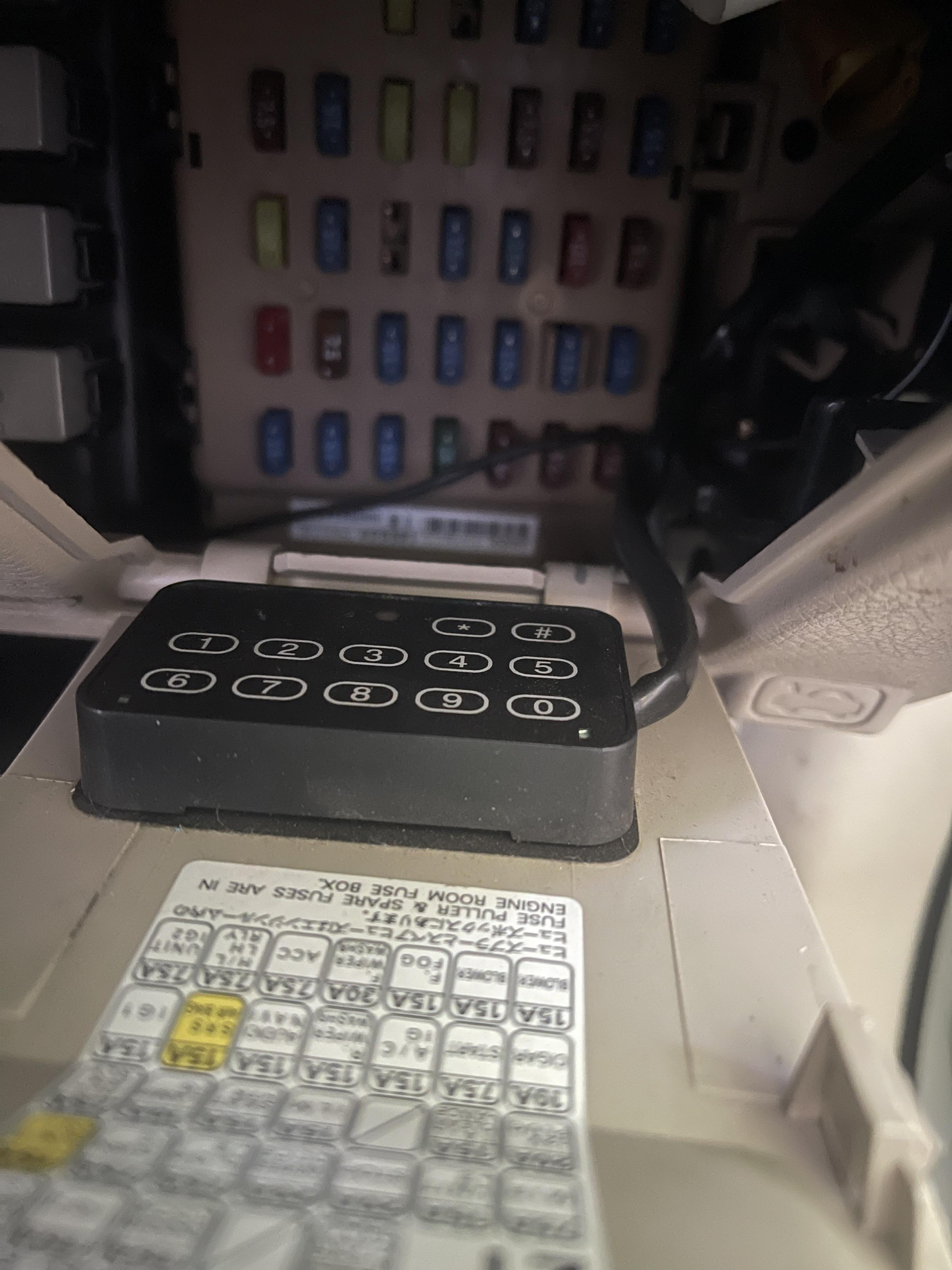

CondorOB1 Posted May 16 Author Report Share Posted May 16 Thanks Mr B - I went and rootled around and found a keypad behind the flap covering the fusebox beneath the steering wheel. Have attached photo. Is this the M30? i also discovered a Grom harness connection in the glovebox and a working Parrot cK3000. Might buy the Grom kit……..exciting times. At least a previous owner loved the car! Do I need Subaru or an auto locksmith to get a key which will start the car with transponder etc or can a key be reprogrammed to full working condition? I found a few of the single button keys on eBay for about £20 but the seller said they can only be used for central locking programming and can’t be reprogrammed to start the car and a new transponder chip will be needed. sorry if I sound confused …….I am 🙂 Quote Link to comment Share on other sites More sharing options...

Mr B Posted May 16 Report Share Posted May 16 Subaru will be stupid money for a key, auto locksmith should be around 40 to £60 for a cut key with a transponder inside programmed to match your existing one. *transponder immobiliser is built in by subaru at factory, the Sigma was added afterwards to meet EU/UK vehicle security laws for imported vehicles . You can buy a used Sigma M30 keyfob and program it yourself, you can also setup a new 4 digit pin using your current working keyfob . Setup a 4 digit pin as first step as if mess fob programming up you can still use the pin code to try process again . M30 instructions attached ... m30.pdf Quote Link to comment Share on other sites More sharing options...

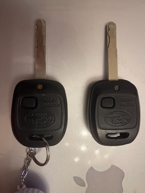

Mr B Posted May 21 Report Share Posted May 21 Can you do a picture front and back of your original remote and the one you bought used . Sounds like it either incompatible remote or faulty ... Have you tried programming and trying the eBay one first and see if recognises it and bleeps ? Quote Link to comment Share on other sites More sharing options...

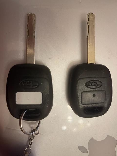

CondorOB1 Posted May 21 Author Report Share Posted May 21 The remotes are pictured below - the original working one is the one with the ring through it on the left of the photos- rear has a white sticker but unfortunately the numbers have rubbed off. No identification on the other remote at all. They both look identical. I did order some spare batteries and thought I might try a new Battery before sending it back. There were a few of these remotes on eBay which all look the same - is there a particular link to one I should buy instead? Quote Link to comment Share on other sites More sharing options...
Mr B Posted May 21 Report Share Posted May 21 swap Battery to original one and see if Battery good by arming/disarming alarm . Isn't uncommon have dead buttons on these, you can tell well used ones as the soft touch coating wears off and the button will of lost it's tactile feel . With the tags not being readable on back could not be 100% on the comparability but initial gut feeling is either battery/battery contact or faulty button ! your eBay one does physically look likely well used . Quote Link to comment Share on other sites More sharing options...
