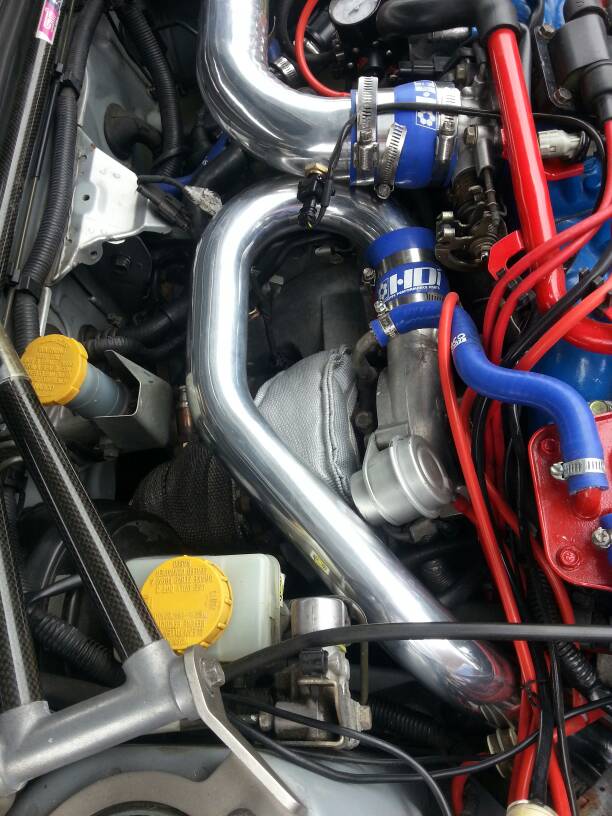

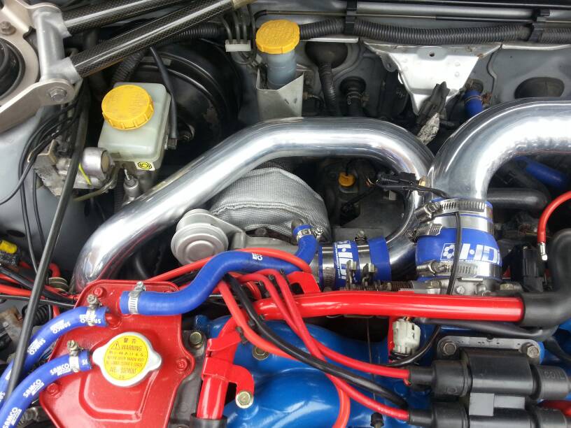

Well it was a bit awkward to fit due to the scooby set up but , not because of the actual blanket . It seems to be good quality and after a spirited drive the turbo outlet fmic pipe is much cooler , as I can keep my hand on it now (rather than scalding myself on it )
My intake temps were much better since fitting the hdi fmic but now the air temp going into the cooler should be lower I'd imagine the intake temps into the throttle body will be better still [emoji6]
