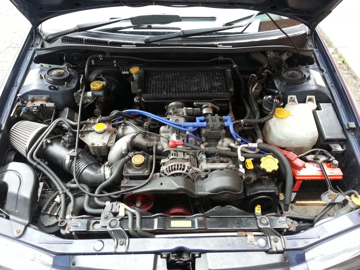

Hi ppl ive just bought a 1999 subaru uk2000 turbo it has cone filter and decat straight through prodrive exhaust system ive just put 10mm ht leads on it n new lightweight pulleys and a full service done and now looking at getting a walbro 255lph fuel pump and fuel pressure regulator then getting it remapped any idea what bhp I should get from it all?
depending what it is standard but done right you could be looking at an average increse of around 40 ish brake. all depending on what re map you have done. but if you are going that route then get some 440 injectors and you might get up to 320 maybe more
