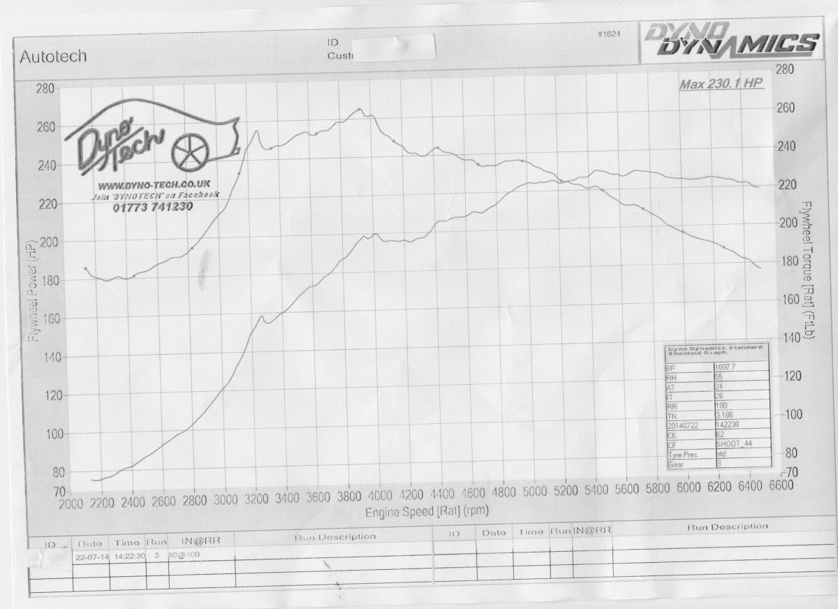

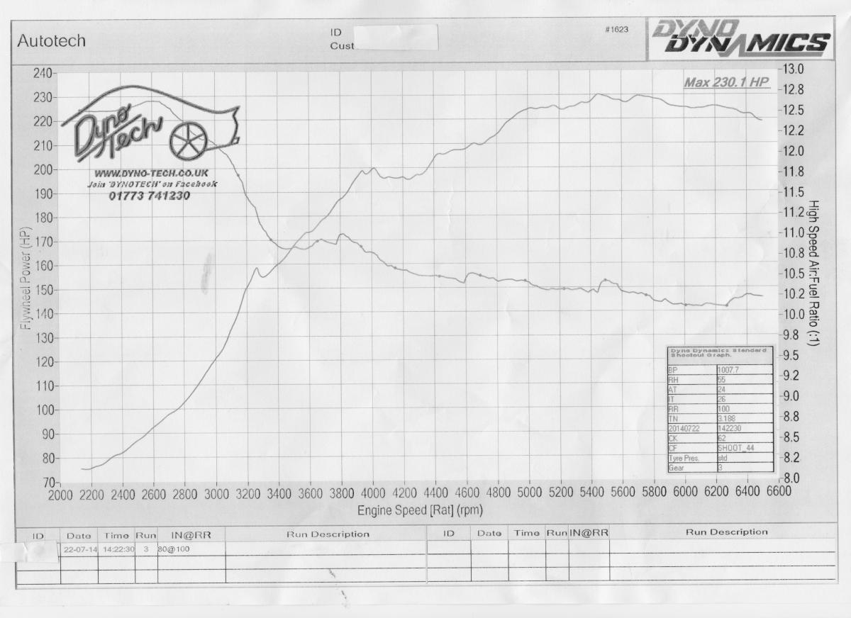

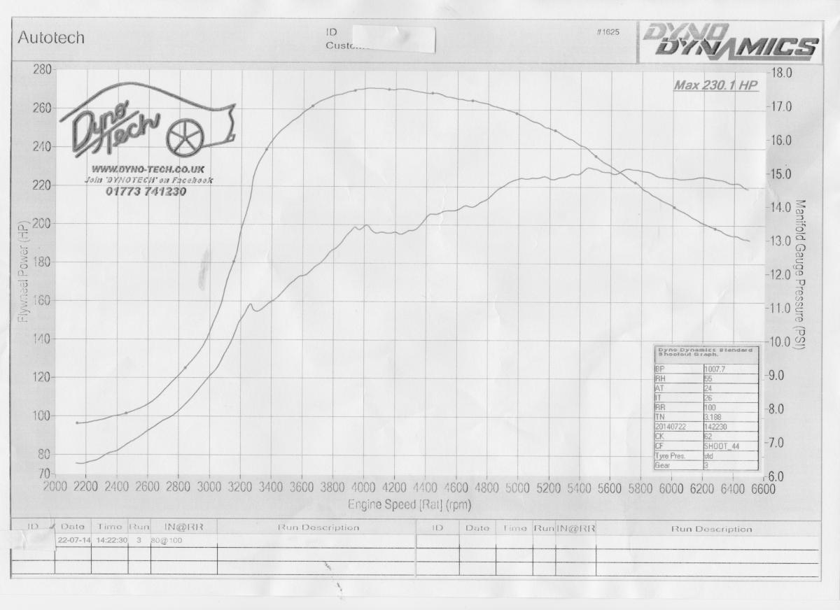

On the rolling road the chart showed the missfire when it hit boost the boost pressure held a smooth line all the way he told me it could be a coil pack going bad but would not know which one until it threw a cel which it did not do on the dyno,The engine never put out one bit of smoke neither any mist of water vapour at all under boost so the theory of the head lifting a bit under pressure kind of ruled that out for me anyways at least.And the thought of buying a full set of coil packs would be an expensive buy as all i keep hearing is these very rarely go wrong and it would be labour intensive to get one and go through them that way and being told there is no other way of testing them, its also been on a run and data logged nothing showed up?.

The engine is in tip top shape as far as i can tell and thinking about it it may be down to the mapping i do not know who did it, the mods that have been done is the pro drive exaust put on and one cat removed there is no blow off valve or any other mod that can be seen,it could well be down to timing it may of had a bigger intercooler on it and taken off and just the exaust left on i don't know,? they did a sniff test with the emissions tester held over the overflow bottle and rad it did not move he had to put it near the exaust to check it was working it is a strange one i have put up the dyno runs so you can have a look see what you think.
