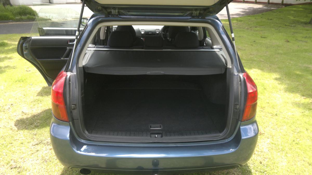

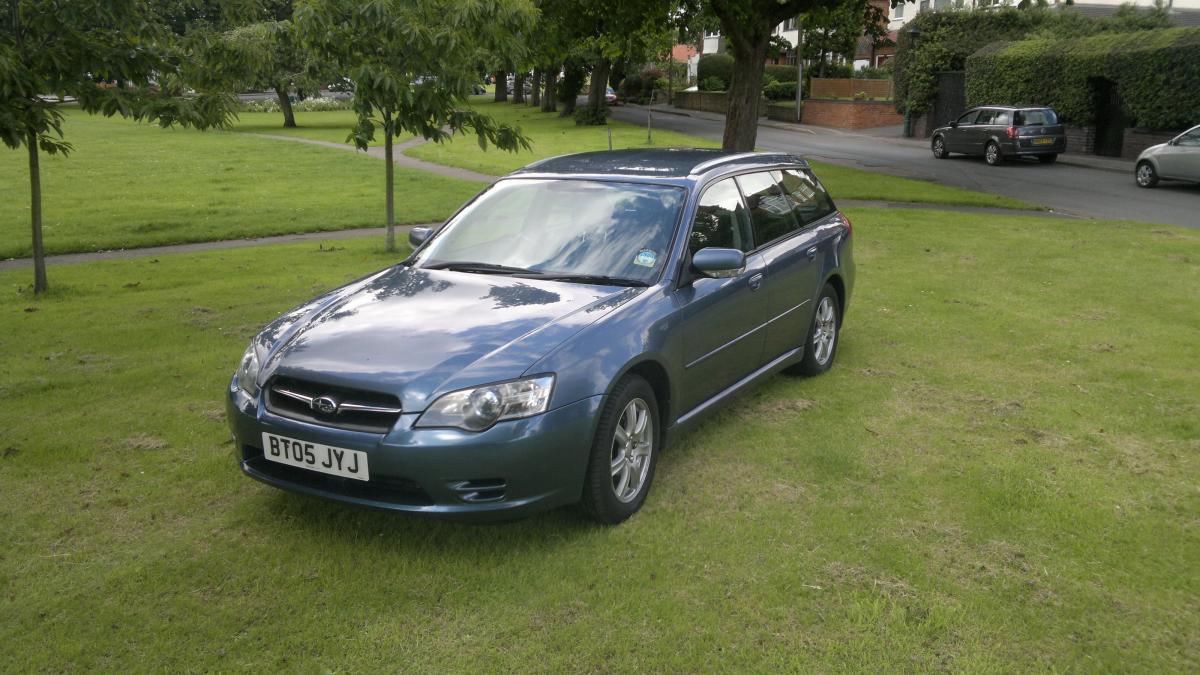

just to show why i wanted her back on the road!
AS I said before she does look mint condition through out :)
