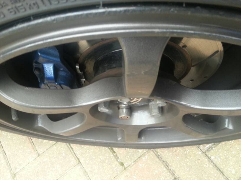

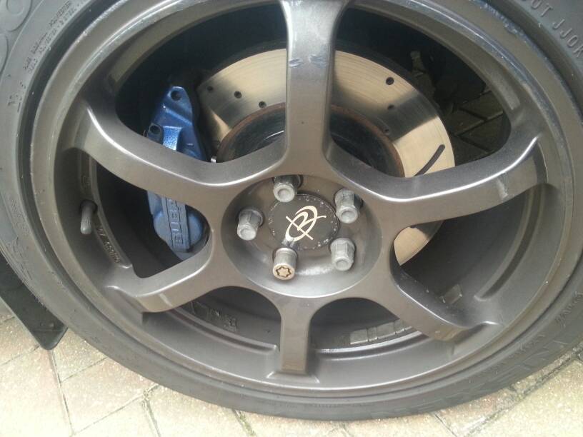

I sold my 18" prodrive a mate and they were perfect over brembo's
really ? i know someone that had loads of trouble with them but he was using slightly bigger discs than standard brembos ones.

Ur not on brembo's tho pal my calipers are huge compared to them. Never mind I'll figure it out. As I dnt no exactly what wheels I could be buying I jus no they speedline and only as a spare set so that post doesn't help me lol but good info all the same.
