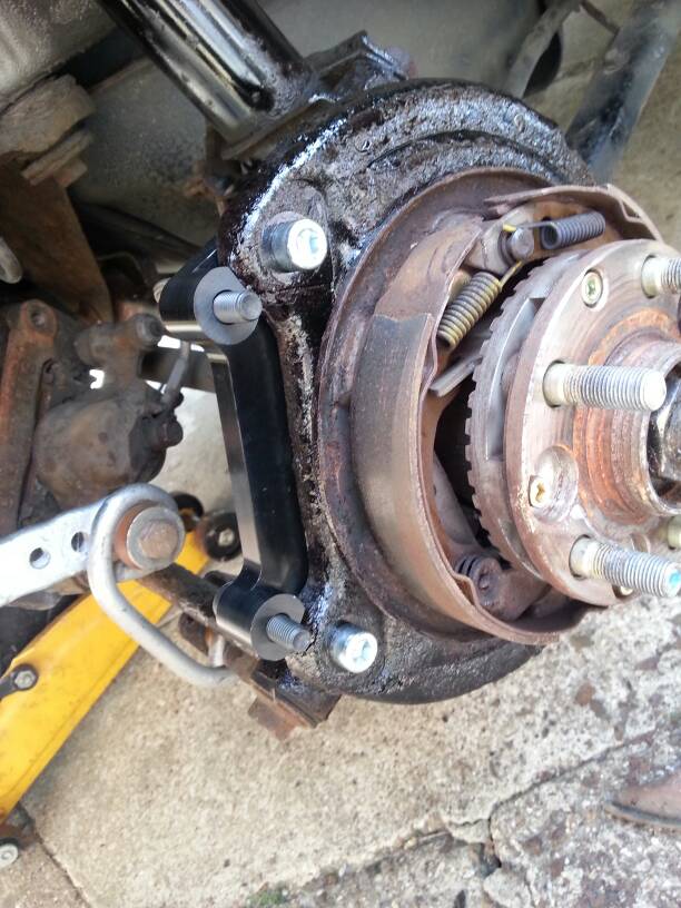

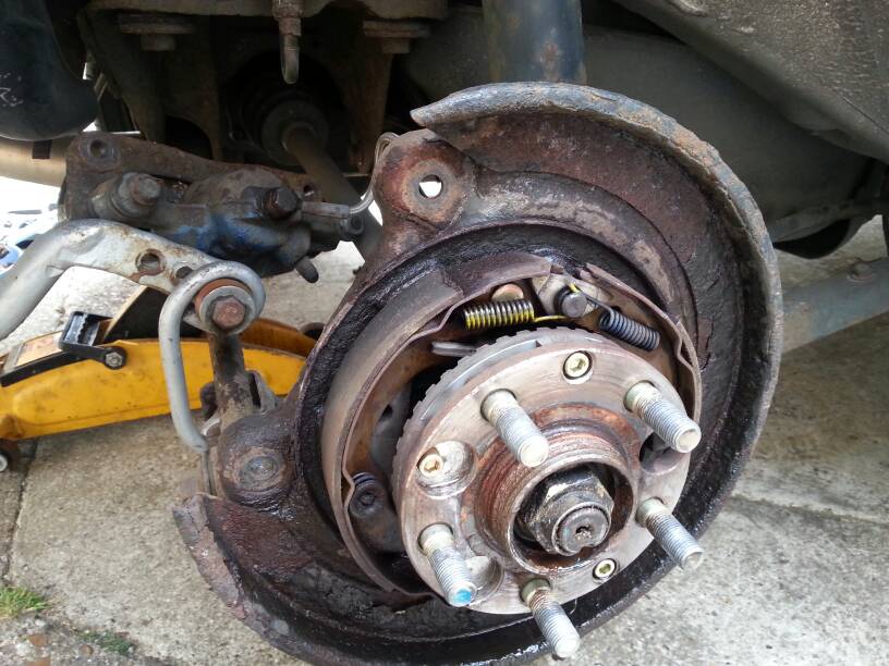

Rear 2 pots have to have conversion brackets ,to move the calipers away from the centre of the hub. Which allows you to fit the bigger dia rear discs , the bigger discs foul on the rear splash guards so you have to remove them .
Old discs off
Splash guards removed and brackets fitted
I bought my 2 pot rear calipers with newage wrx 160 rear discs (off a mate ) and new pads and the conversion brackets from alyn @ as performance ,google and phone alyn as he's website doesn't list everything he sells
