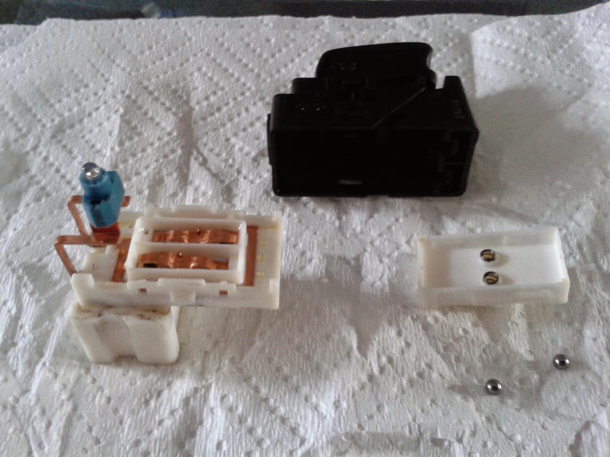

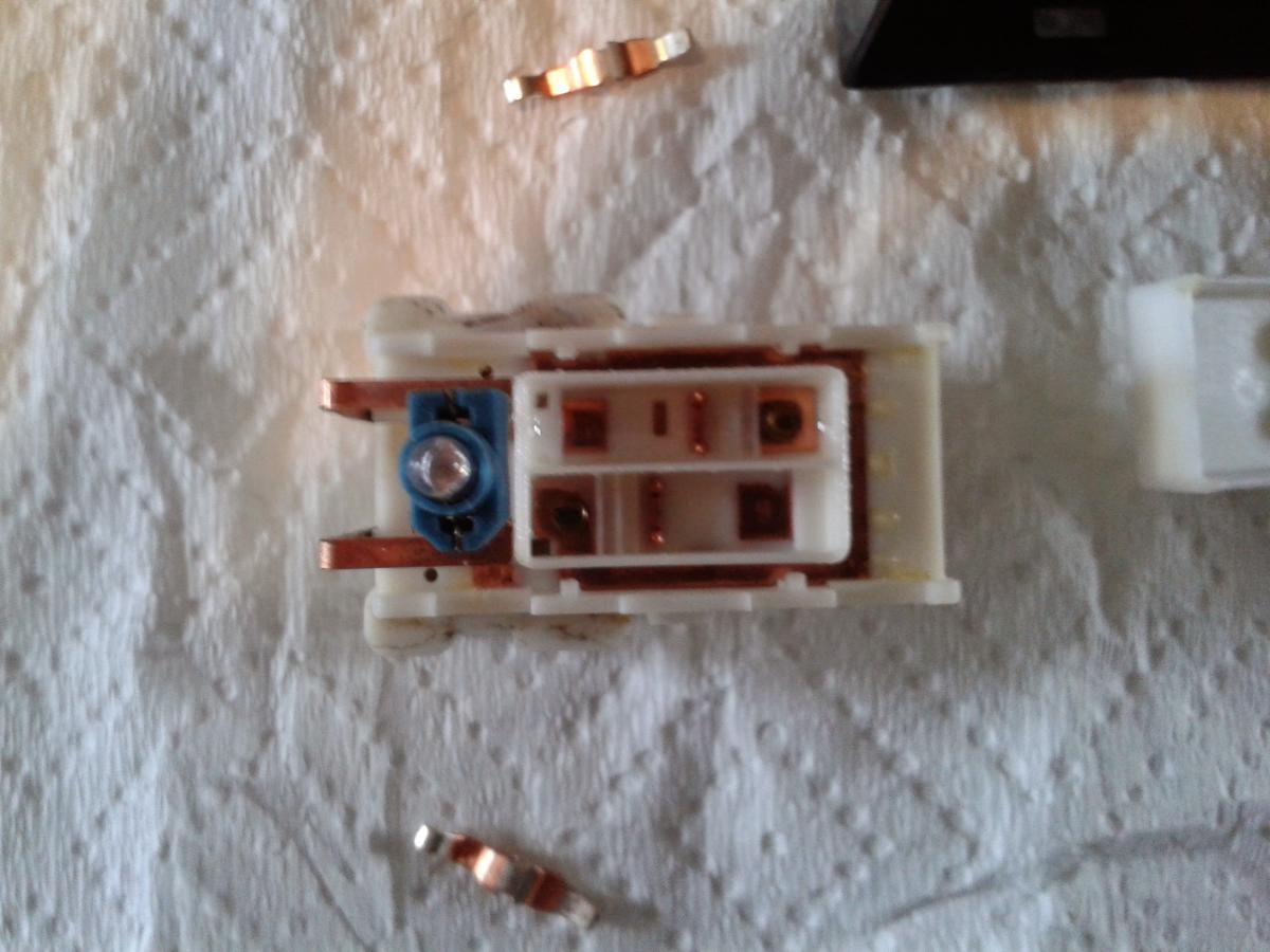

if you pressd the button with your lights on do they slightly dimm? if so it might be stuck. if not may be the switch it self as they are not the best out there. i made a how too on a Australian forum when i was living there. those switches are not too difficult to dismantel and clean the contacts with sand paper.
when i have the time i will see if i can find my post.
Switches are not that bad & indeed as bitman has said can be opened for cleaning/inspection

still think that those switches are not so great as many Australian Subaru owners have problems of getting the contacts inside the switches dirty (burned) as a result not working. Many be we open the windows more (nice weather) then here in the UK? Or it's the dust?
anyway only on the MY03 i had in Australia 3 out of the 7 switches didn't work...
Thanks bitman.
I would still appreciate it if you get chance to find that post regarding stripping and cleaning the switch as it could be of use to one of us Subaru owners in the future.

not found my forum post yet, but i did found the pictures on my abandoned Google+ (biton walstra) page;
post-1873-0-63968400-1401005309_thumb.jp
post-1873-0-79154800-1401005329_thumb.jp
post-1873-0-65648300-1401005344_thumb.jp
now I will try to clean mine, almost same symptoms , with the only difference that my window closes in jumps
