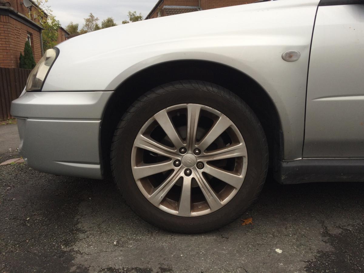

One last thing fellas, I've got 17" rims on at the minute with 245/45R tyres. When getting my tracking done the guy at ATS suggested the tyres weren't right for my car? But another garage I went to to have my wheels swapped around said they were fine? Can anyone shed any light on this? I've always thought my car sat a little bit high, (the gap between the arch and the wheel is what I mean).
post-3243-0-88177200-1413795421_thumb.jp
post-3243-0-71376000-1413795459_thumb.jp
could this be why I'm having problems keeping it on the road in the wet??
Do you know what was the oem rim size ?
If you go up from stock you newd to decrease the sidewall hight tp take into account the increase, bigger rims would normally give a harsher ride and be more 'crashy' over lumps and bumps, having the tyres overinflated will cause the contact patch of the surface of the tyre to be smaller giving less grip and increased tyre wear
