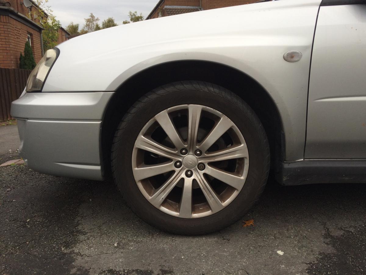

Cheers Scooby Pete. Yeah mate It happens when Im coming off the accelerator. Tried testing it on my way home from work to see if the tracking an tyres being swapped around have made it any better, but it's dry today so couldn't really tell as it's been fairly ok in the dry anyway. Still making me nervous on the roundabouts though.

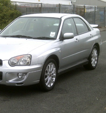

Sorry Stants I overlooked your post from yday by mistake, sorry to be a dumbass but was does oem mean? When I bought the car it came with 17" rims and 245/45 wheels on it. I let a bit of air out of the tyres yday so the back are around 29-30psi and the front are around 32-35psi.
No worries, basically ome equates yo how it came from the factory. Did it come with 16" or 17" rims as standard
Do you have a sticker like this inside drivers door ?
Tells you what size rims with which combination of tyres you can put on the car.
Have a peek and see what it references with what you've got on
My 2004 WRX has 214/45 R17 as standard.
I did have a bug GX and that had 16's. Can't remember the other dimensions
I've heard of people putting 225's on and R18 on a WRX but not 245's....and certainly not on a GX
Cheers guys sorry didn't get back sooner, (late shifts this week I'm afraid) Stants the sticker on the inside of the door gives advice for 15" rims. I'm assuming this was was probably the original size rims that were on the car from the factory before these 17s were put on it?
Cheers JusNoGood I'm kinda thinking the wrong tyres have been put on at some point. Might have to get 4 new ones next payday.
I did notice a better hold and handling on the road on the way home from work after having the tracking done but still not convinced the problems been solved.
Been informed by another garage (a trusted one) that the wheels are too wide for the car. Hopefully once I get this sorted will rectify everything.
Yea I'd suggest going to standard 215's.
