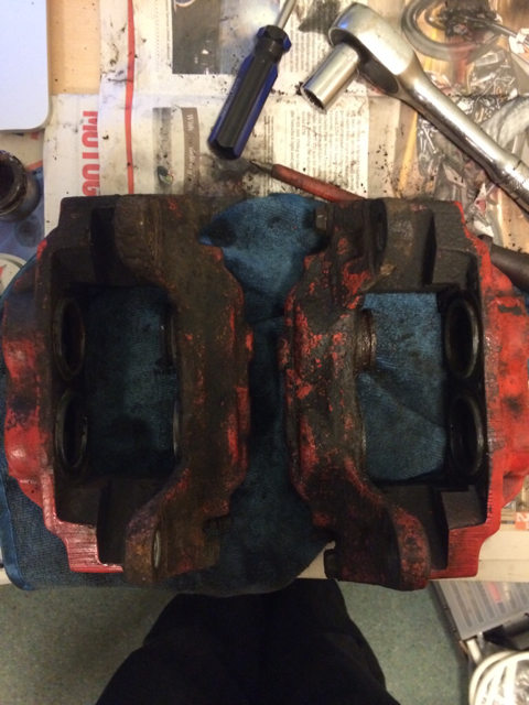

BlackBosh Posted October 21, 2014 Posted October 21, 2014 Thought you'd got rid of me! Well I got rid of the Astra instead so now only have the Subaru and a gorgeous new triumph to drain the wallet. Its now easier to focus on my baby. finally decided to do my calipers from *cough february cough* Luckily I bought a spare set cheap and think they maybe on the way as well so want another set to swap straight on. My question to yous guys is how the fudge do I remove the seized pistons notice they are on the "same" side Any idea on the best place to get seals as well as maybe a couple of pistons as the majority are reusable. TIA & sos if this is wrong spot gambit, feel like a newbie again

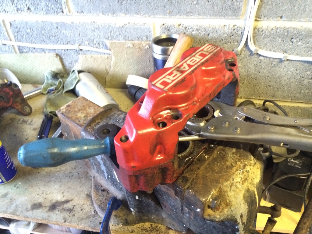

BlackBosh Posted October 23, 2014 Author Posted October 23, 2014 This was how i managed it took me 20 minutes but thanks for the suggestions, lesson learnt from this, bolt my vice down haha
BlackBosh Posted October 23, 2014 Author Posted October 23, 2014 Looking at the parts it seems the calipers are the culprits not the pistons. Hmm

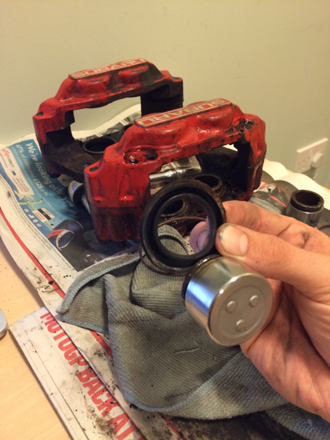

BlackBosh Posted October 28, 2014 Author Posted October 28, 2014 Managed to salvage 4 pistons, the other 4 were either damaged by me removing them or were already pitted and knackered before I started.Β

BlackBosh Posted October 28, 2014 Author Posted October 28, 2014 They come in sets per side 4 are literally intact and taken from opposite sides as clearly there is a weak point for corrosion, The 2 that were stuck fast were in the mirror position of each other, If you follow. It's only Β£20 for a seal set as well so saving a fair bit of dosh as other things need buying this month 1
