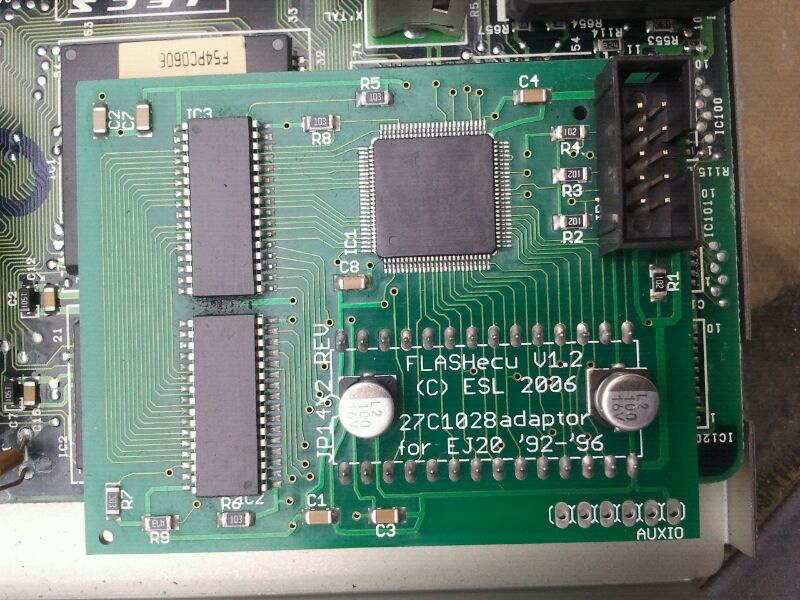

If it is a subaru ecu (not aftermarket) it would need to have a esl daughter board fitted in order to be remapped , the only way to find out is to unplug the ecu , take the cover off and look for a circuit board with esl 93/96 printed on it

I think 7d is the standard ecu for your age uk turbo you but it still could be mapped if it has a esl or alcertek ecu board in it .
Although I do doubt that it has been mapped due to it having a manual boost controller .

Here's a pic of a early esl'd ecu so you can check if it's been mapped or can be remapped
