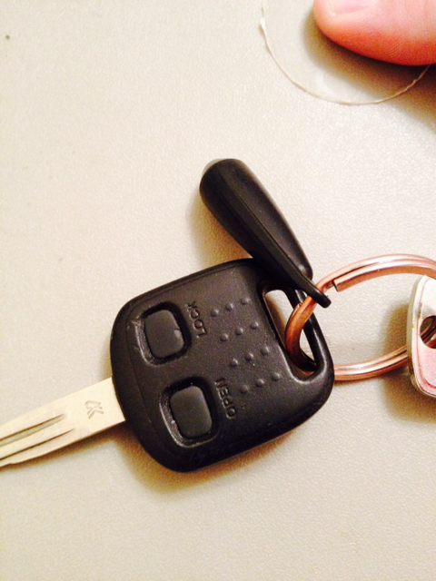

Anybody had any experience of adding an additional key to a 2005 Sti import.
I only have one key right now and want another but not wanting to pay with my trousers around the ankles.
Cheers

The key or the dongle thing ? If dongle no idea. But my import has the same key but does absolutely nothing. I'm LED to believe there's no immobiliser in the key so you could just get a blank and get one cut. My alarm is all done off the aftermarket fob
Yeah I'm thinking leave the immobiliser thing and get a new key for the alarm. Is that much simpler to lock and unlock

You don't have an alarm do you !? or have you got a sigma as well !?, the 2 buttons on the key are purely remote central locking from factory unless upgraded by a sigma.
When imported your JDM car would of had the tear drop transponder immobiliser fitted as part of UK conversion as vehicles of that age in UK need an immobiliser as minimum security requirement to pass testing.
Your particular touch type transponder is a bit crap to use.
What paperwork do you have for alarm as UK insurance would want this so you should have something.
UK cars came with transponder inbuilt into key along with remote central locking.
Sigma was a full secondary alarm option from UK Subaru dealers & added to work with original key fob housing.
If you don't want use the teardrop touch responder you will have to remove & upgrade immobiliser/alarm system & have certificate for insurance ...

Yeh I would probably go with half decent cat1 system & dump the teardrop transponder & the key with fob.
I would get 2 standard metal keys cut, maybe on scooby or STI emblem blanks & have the cat1 alarm fobs work the central locking direct. easy live with over current setup plus insurance will like cat1 cert.
I quite like autowatch, sigma & Cobra alarms but worth doing some research so buy something you happy with, alarms are quite cheap these days ...
Those touch style immobilisers are normally only done as cheapest option for importers (about £75 trade)
